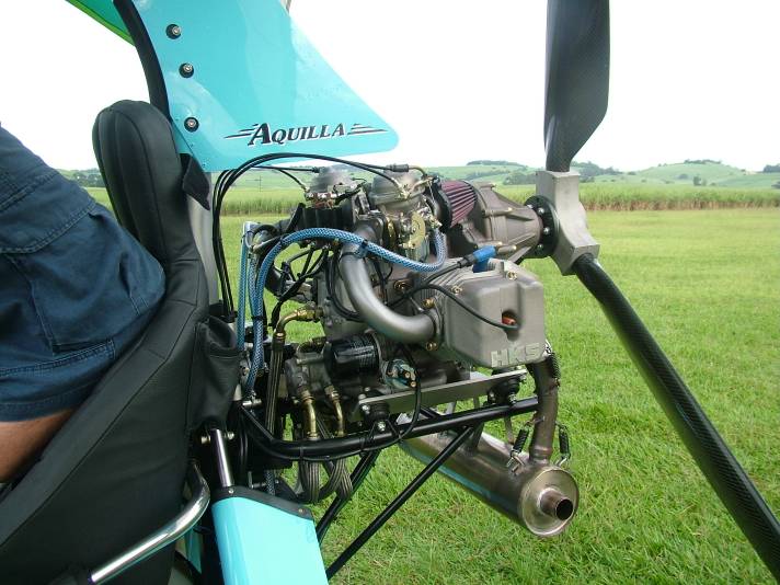

From the HKS website:
2005.05.09
You may be interested to know that after 50 hours trouble free flying the motor is run in and now delivers approximately 10 % more power than new, with the trike at sea level I obtain 1000ft per minute climb out (582 is 1100 ft) so I am very pleased with the performance. Fuel burn solo 8 litres per hour. It is very obvious that the engine requires a good run in period before it delivers full power. I use Shell synthetic 5w-40w oil. Oil temp at about 90 degrees C. No oil leaks at all.
Cheers Paul
So if the local boytjies can't come up with the goods...
