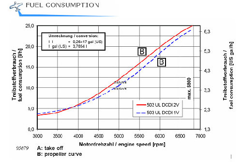

503 full throttle is about 25lph.
582 should be about the same. not sure though.

When I flew to Botswana with my 503 i was burning an average of 18 l/h fully loaded. The accompanying 582 if i can remeber correctly was averaging 13 l/h. Also consider that we were flying throughout the day and it can get pretty hot and we weren't at sea level.. Cool sea level and the consumption should come down.

Hi Jaco,
Here is the data youre looking for. It is available at http://www.aviation-engines.co.za/produ ... s&theID=62 under technical data.
There you will see that max on take off and full rpm of 6800 you will burn 25lph. At cruise on 5400rpm you should burn 15lph. Hope this will help.
