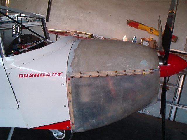

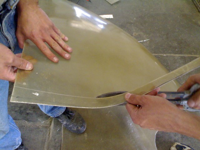

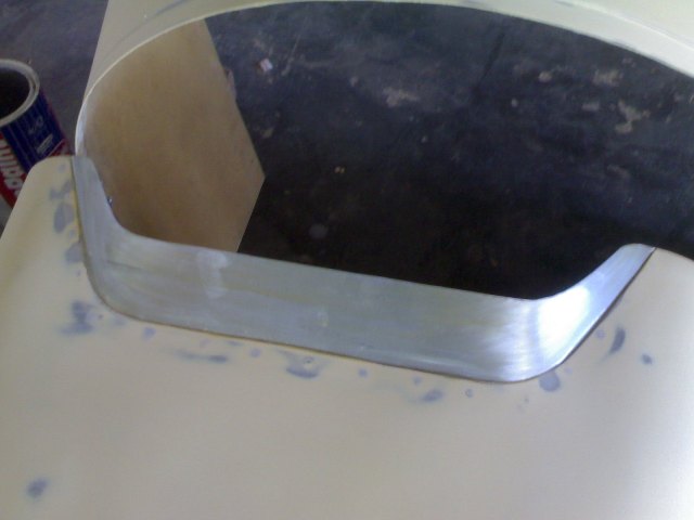

Postby Boet » Thu Oct 11, 2007 8:07 pm
Eish.....difficult helping the man. "Bennie, jy moet eers die cowling trail-fit met clecos...." Bennie: "Boet, wat de joos is CLECOS???". SIGH. How to explain?? :shock: :roll:
Benna, your BB looks like a lady wearing HUGELY oversize panties. I will post some "HOW TO`S" on this, so everyone will come away a bit wiser. :D
Remember: It is NOT ONLY how much COOL air you can get in at the top, even more important to get rid of the HOT air underneath. That is why you have to make and fit a VENTURI in the bottom lip of the cowling, so that the forward speed of the a/c will cause suction underneath the cowl, therby sucking even more hot air out. Observe, learn from it. :wink:

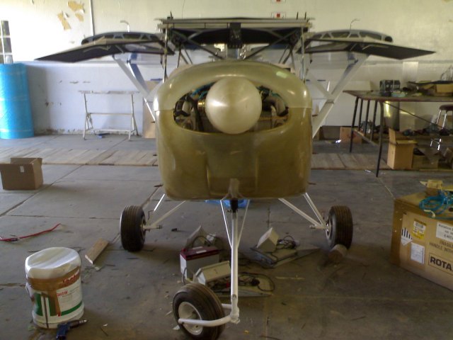

Postby Boet » Thu Oct 11, 2007 8:12 pm
And 2 more pics. :D

Postby Bennie Vorster » Tue Oct 16, 2007 6:27 pm
Hoop dit lyk nou beter Boet. :wink:
