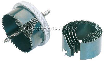

Very easy to install, but just be carefull. Buy a 80mm circular cutting blade that you attach to a drill. The finer the cutting teeth the better It has a centre drill bit that makes a pilot hole. Then cover the area to be cut on the window with masking tape. Carefully drill the centre pilot hole and then the larger hole. Be careful, lexan scratches very easily. Then take the vent, Squeeze the sides where the spring is attached and pop the back through the hole. literally a 5 minutes job

I personally prefer this make of hole saw. Those with the segmented rings oftena are not quite that good.
http://www.starrett.co.uk/products/sawblades/hole-saws/
Little more expensive but a much better result. Available at most Mica stores.

yes, couldn't find a pic of one.
Be gentle, not too much pressure so you crack the rest of the window.
