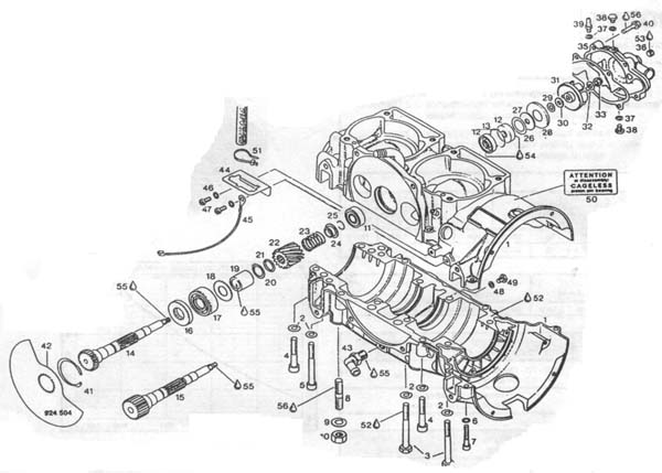

Postby Sad-Ham » Thu Jan 03, 2013 1:13 pm
Sounds more like the seal on the rotary valve shaft has gone and not the seal on the crank. this would allow the oil to seep into the crankcase and be burnt off (Seal Part No 16). Had a simmilar problem but mine was on the waterpump side of the rotary valve shaft (Seal No 12) allowing water to seep into the oil. I might be wrong but it might be worth finding out before splashing out R15k on a new crank! (**) (**)

Postby Loco » Thu Jan 03, 2013 1:20 pm
Sad-Ham wrote:Sounds more like the seal on the rotary valve shaft has gone and not the seal on the crank. this would allow the oil to seep into the crankcase and be burnt off (Seal Part No 16). Had a simmilar problem but mine was on the waterpump side of the rotary valve shaft (Seal No 12) allowing water to seep into the oil. I might be wrong but it might be worth finding out before splashing out R15k on a new crank! (**) (**)
Many thanks! I'm getting Alex Rudd to come check for a 2'nd opinion this Saturday I really really hope it's just the rotary valve shaft seal...... :(
