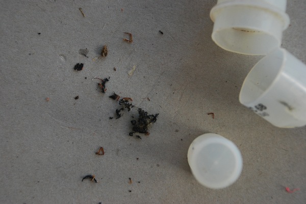

When flying at Aurora I can either drive 40 minutes to get fuel at Piketberg, or buy locally. I buy locally, and this is the result...
Some insect parts, scrapings of sorts?

Dit lyk vir my na organic fuel.

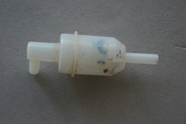

Gert. Dirk and I had a similar problem on Saturday with DizZY. Not as much contaminants as yours but enough to power drop at about 5500RPM. I had refuelled with new fuel from a well used petrol station. I have not yet opened up the filter but will do so. I hope this is not a trend as far as fuel quality is concerned. Needless to say we did replace the filter before flying out. Glenn.
