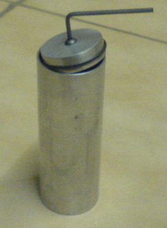

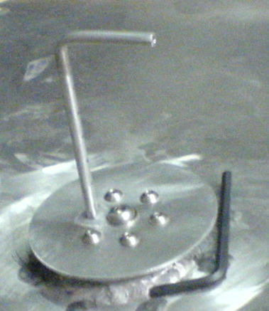

I remembered an ideal flush fuel cap for my tank - the Jabiru fuel cap. Popped the factory a mail, to see if they will sell them separately, but they didn't even bother replying, so I assume they don't. Fortunately the design is incredibly simple, so I thought I would give it a bash:
Absolutely leak proof, and takes about 40kg of force to move it when tightened. I am a belt and braces guy though, so I will make it fasten to the fuselage skin too.

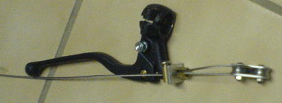

Also did some work on the cable brakes, before Tailspin talked me into disk brakes:
A simple motorcycle brake handle to mount to the control column. A little pulley doubler increases the cable tension. Gives the same cable tension as the original long lever, but obviously total movement is much smaller. Can only work if the brakes are perfectly adjusted.

Justin
Can you give me more info on the Brake Lever setup.
I got small hands and the whole brake lever setup on my Sunbird is Questionable at best.
justin.schoeman
Posts: 1234
Re: Justin's Raven
Postby justin.schoeman » Thu Oct 01, 2009 10:11 am
Tailspin wrote:Justin
It is a standard motorcycle brake lever, but the cable goes around a pully, and back to a fixed point on the handle. This is the classic 'single pulley doubler'. Since the tension on the cable is the same at all points, you effectively have double the force pulling on the pulley.
It has the same effect as doubling the length of the brake lever, BUT it halves the length of the pull - so where you would pull the brake cable 1cm before, it will now only move 0.5cm, but it can exert double the force to move it that 0.5cm.
The pulley has two pulley blocks - the bottom pulley has a single cable that goes from one brake, around the pulley, and out to the other brake. This pulley just ensures that the cable tension is ditributed equally to both brakes.

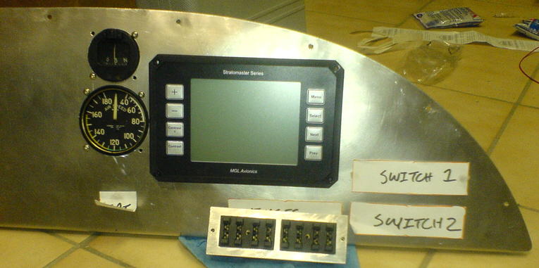

Spent a good couple of hours, and a number of dremel grinding discs, cutting up the panel, starting to fit the instruments:
Slowly but surely starting to look like a real panel :wink: .

Finished most of the work on the fuel tank, and thought I would do a small test. Put the cap in, blocked up the breather, and hooked the compressor up to the fuel outlet. Pumped the whole lot up to 1 bar. Bulged quite alarmingly, but not one leak, and the fuel cap didn't budge - even without any additional restraint - just the squished o-ring.
Looks like this is going to work perfectly :D .

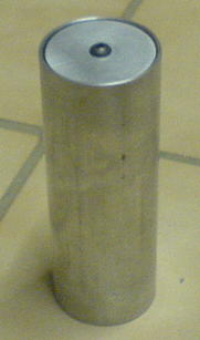

1) Finished off the fuel cap:
Came out much better than expected.

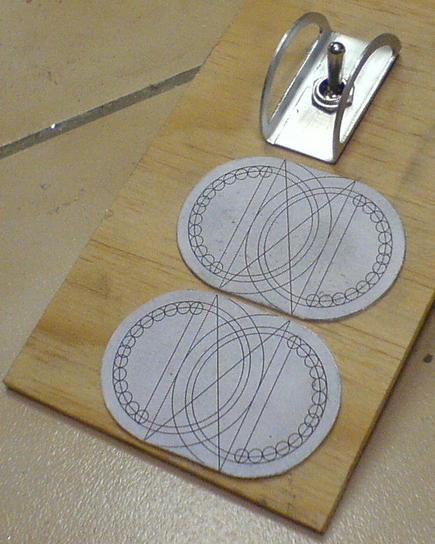

2) Started making the switch guards. One finished, and two blanks cut.
I actually really enjoy working with aluminium. I wish I had done some metalwork at school. It is kind of nice when you finish filing two blanks, put them on top of each other, and can barely see the seam. (Pity it doesn't always work out that well though!)
