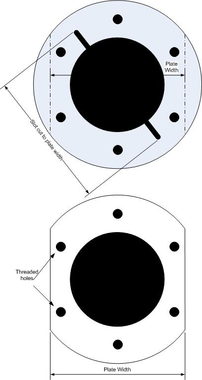

Thinking further about Georgeh's problem wrt the fuel level sender leaking. Ranger and I were looking at Gadget's plane the other day and the holes in the plastic tank that the screws need to bind have worn such that either you put in bigger screws or come up with a different idea. The plastic of the tank is just not strong enough to allow you to tighten it up to a proper seal.
This led Ranger to devising a backing plate that would be threaded with a nice fine thread (not self tapping as is normally used). But the challenge comes in how you get it into the tank.
So this is what came up. Create a round backing plate, with holes etc, shave two of the sides down. Cut a slot in the plastic that equals this new shaved down plate width.
Then pass the plate through, maybe using a string to stop you from dropping it, position at the back, place the rubber/cork gasket over the top, add the fuel level sender and screw the whole lot together
Capice 8)

My fuel level sensor I bought from diesel electric, had about the same design. Works like a charm, but to get it fit ... (**) (**) . Took me 3 hours, and a lot of head scratching, because you don't want to take out to much tank now!! ## ##

haven't been back here since i sorted my leaking sender unit. the drawing above are similar to what i done. most important was to use capscrews, machine a groove on the underside for an o-ring.
haven't had a drip since.
George
