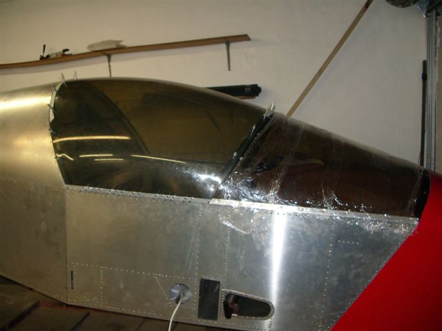

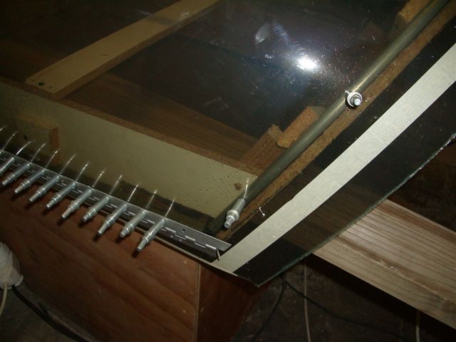

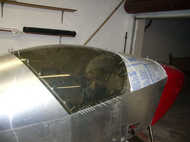

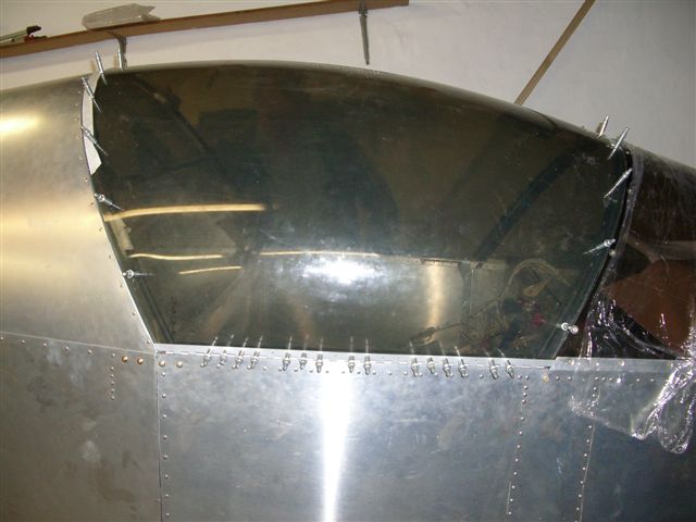

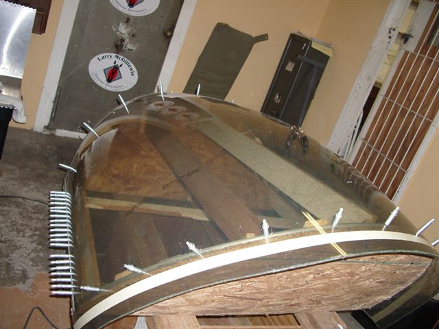

OK, going well again!
Canopy basically done, just need to drill and tap larger holes for the bows, and finish the latch. Have fitted the tail wheel fairing - looks tiny! Painted the glareshield.
Fit a few fairings, move the plane to the airfield ths weekend, fit wings, then rigging etc, so getting closer all the time.
Below some pics.

Postby LarryMcG » Tue Jul 22, 2008 9:24 am
More

Postby LarryMcG » Tue Jul 22, 2008 9:27 am
Last for now!

Hi Larry,
Wow looks really nice! Sorry about your first canopy cracking
Ja the Canopy, cracking, sorry saw this late, but I decided to glue my RV canopy with Sikaflex. Sika much stronger that rivets or screws, did the comparitive test myself. Chances of cracking very small, cause you don't drill holes, and don't attach with fastners. The expanding ratio between fastners, metal and plexi very different, hence over time cracks can develop, ask the RV guys they know all about it. Some people drill slightly oversized holes to compensate for difference in expansion.
If I do it again I will sika glue it again.
PS: Some tips I picked up on the web, use a high speed grinder to cut canopy. Before you put any bending force on canopy ensure you smooth and polish the edges, file smooth, scotchbrite edge, and polish with a old rag. The edge needs to be as smooth as a babies bum, any nick or scratch on that edge when you bend it will crack over time. It is much worse than aluminium so take extra care in your preperation. You get special plexi drill with the drill's penetrating angle just right for plexi. If you don't have special plexi drills, blunt your drill first by drill into a brick. A sharp metal drill and plexi canopy not ideal. If you need more info phone me 083-245-9955, but I guess by the time you read this you will be done with your canopy.
