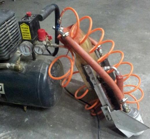

Here is the oil cooler/oil filter assembly. The AP was not happy with the rigid oil line, and the seat of the oil filter fitting was not great (had to really tighten the filter to stop leaks). So while waiting for everything, I replaced the oil line, and resurfaced the filter adapter.
After assembling everything, I pumped oil through it, then blocked it off, and hooked up the compressor. 120PSI and no leaks. This can safely be put back on the engine.
