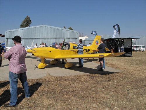

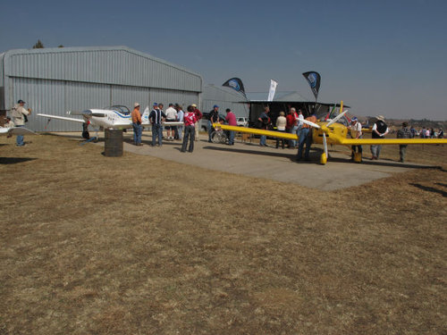

Gavin I was at the show we came in the Aerostar. I enjoyed the show and also the AP meeting. I was having a long talk to Andre Swanepoel and enjoyed that very much unlike what some people would like to believe the chaps at CAA and especially the NTCA department are on our side they are also caught between the old regulations and a bunch of individuals. The spirit of the individuals and and the CAA documentation just must find a golden midway. But it is important that the spirit of the aviators must not be oppressed. There was the wonderful example of our three heroes Chalkie, Mike and James who did flights beyond the imagination of any of the great powers. In the American aviation news gave very little if any to our heroes, however they managed with the help of the NTCA section of the CAA and their "Spirit and enthusiasm". Enclosed I have some pics of the two aircraft at Bethlehem air show. I also saw the Jabiru Explorer I must compliment the Komatipoort team on a very beautiful yellow Explorer

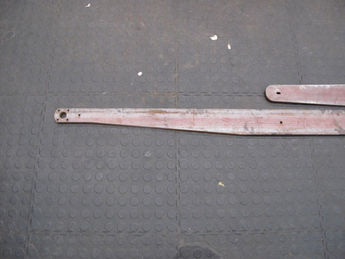

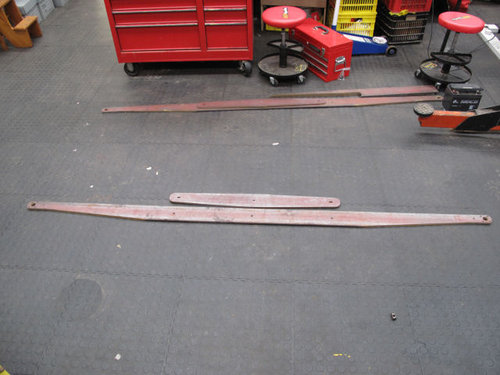

Should get the final gear-legs back from the WaterJet cutters. We have finalised the gear design and are making exact templates for the bending process. This is very important to get both legs equal and to be able to repeat the process if one wants to duplicate the legs. At present the idea is to bend the profile and to put in the necessary toe-in as well. We try to stay away from aligning shims as far as possible. As soon as I have all the parts I will post the pictures. The carbon fibre tubes we glued onto the experimental gear carrying the brake lines were very successful and that idea will be repeated. I have a friend who is a bow and arrow fundi and they brake arrows. The carbon fibre hollow rods can be bought from the model aeroplane shops . I will keep you posted. Monty is walking the papers through CAA today so I'm keeping my fingers crossed.

Today I was informed that I have been using the wrong format logbook so of course I now got the correct logbook. What was more exciting is that I received the components from the Waterjet company for the gear . The edges are going to be rounded and then the final bending and then the heat treatment. These are just refining touches. enjoy the pics. I see we have had 52000 hits , keeping fingers crossed for the CAA paperwork.
