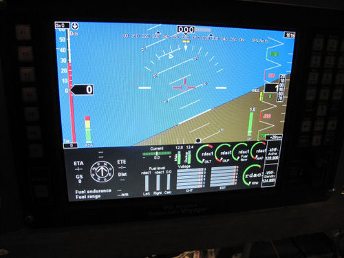

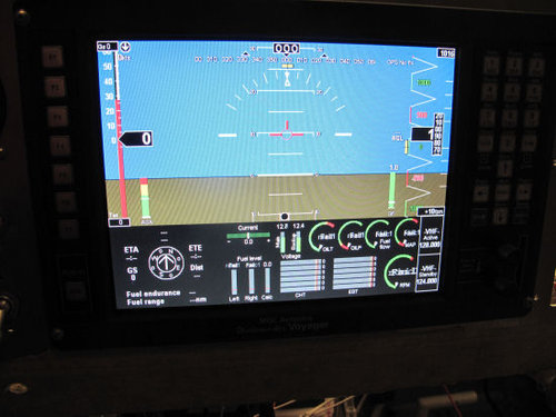

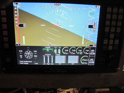

Boet thanks for the trouble I was busy this weekend with the hairstyle of the Bosvarkie but finished the wires of the solid state gyro's suctioned all the filings from the belly and checked in all the gear bolts. Enclosed pics of the display it works very well in straight and level the ball is centre but in the turn to the left the ball also goes left because the centrifugal force is missing and the same to the right. We are marching on and it looks like next weekend she is going to the hangar.

level 10degrees pitch up
Turn to the right
Turn left

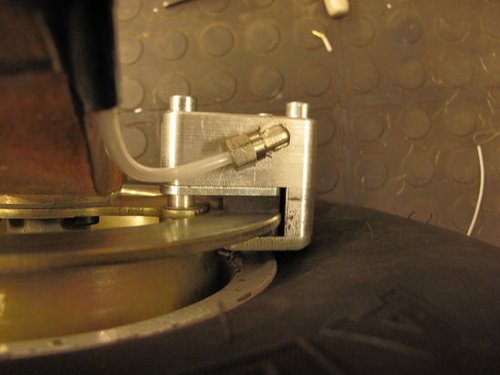

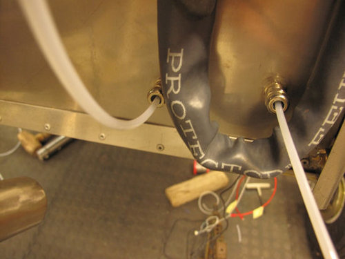

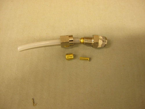

As you realize Boet and myself are in daily contact and cross fertilize each other with idea's and positive criticism when I had fitted the brake system with poli-urethane piping rated to 10 bar he came out with the subtle remarks "daai goed is K*K" I did take note because we do not wan't that kind excretum on the Bosvark. Now that I'm doing all the thousand little things that need doing I replaced all the fitting with the proper stuff . It is a nylon tubing rated to 30 Bar and I got all the nice brass fittings that prevent the pipes from being compressed and later leaks. There are nice fittings where the pipes come through the fire wall and I hope that Boet's critical eye will pass this one. Enclosed some pics
Cheers Oupa-G

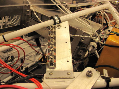

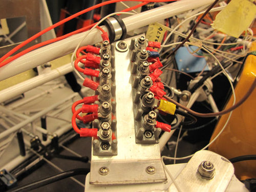

That was on the brake pipe front. On the electrical side I had to disconnect all the wires that is the only way one can untangle a temporary wiring and make it a permanent loom. Some wires are to long and some to short, but I can now see the light in the end of the tunnel. I made the bracket for the bussbar and on the negative side all the poles are connected and the main earth will go to the block of the engine to prevent earthing through the instruments during start-up.
On the positive side you will see that the Bussbar is divided into two section three poles for the alternator circuit and three poles for the battery circuit. The batt and the alternator are connected by a 15amp circuit breaker . So normally batt and alt are functioning as one system. In case of abnormal function of either batt or alt the circuit breaker will trip and we then have two separate systems. At this stage all nuts are hand tight and once the loom is finished all will be tightened.
Enclosed some pics and then of to bed.
Cheers Oupa-G
Postby Boet » Fri Jul 10, 2009 6:29 pm
Spaghetti.
