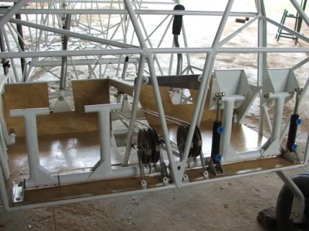

Rudder pedals, Rudder cables, Controlle sticks and Floor boards installed
Goose
Location: Pretoria, FAWB
Re: My Kitfox7 SS Project
Postby Goose » Sun Jan 11, 2009 1:45 pm
Rudder rips and elevator trim actuator installed
