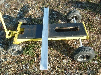

If I understand you correctly you are referring to the neat contraption with wheels on which the wing is resting. Whose contraption is it? I would like one too. This will allow one to put the wing down and push it into a lower hangar. Its also great for general wing maintenence. Where did you see it???

Found it while lookin for he BRS stuff. http://www.first-light.net/index.php?section=1&page=17 Looks pretty simple and assume it could be made very easily.

You did'nt answer my question: Where did you see this dolly gizmo???
Its not common for sure. Most often seen as you yourself mentioned is a sideways dolly. Many many years ago Demon used to Hangar in a little store room near blue hills. He literally had to take his wing off each time and walk it into the room as it was not high enough to accommodate the trike and wing together. This gismo would have been very useful for him then. He will probably deny this useful bit of his history, but I remember very well :D
I am interested as it can come in very handy for washing the wing and doing maintenance etc. :idea:

I don,t have any plans just built it.It started out A small riding lawn mower.I used the frame and the steering tie rods, front axels and welded it onto A handle so it can steer.The handel removes for A tow handel for A tractor. A straight axel in the rear. Plywood for the top with A hole cut for the wheel with underlinning brackets to hold the bottom of the wheel. U channal aluminum for the trikes control bar.
I will get some pics for you Robert

The platform is 3 feet long by 1 foot wide.The rear wheels are 34 inches apart.And the front wheels are 2 feet apart.As you can see in the photo, the handle and the steering mechanism is made from 1 inch galvinized plumbing pipe.
Let me know if you get the photos ok.
Happy flying,
Robert

Thanks for all the trouble to get me those pics. I am very impressed with the dolly, it would be very useful around my hangar. I think I am going to get somebody to make one up for me.
It looks really useful for washing the wing and doing general maintenance on the wing. Also for moving the plane back and forth in the hangar. Especially useful for guys sharing a hangar like I am.
