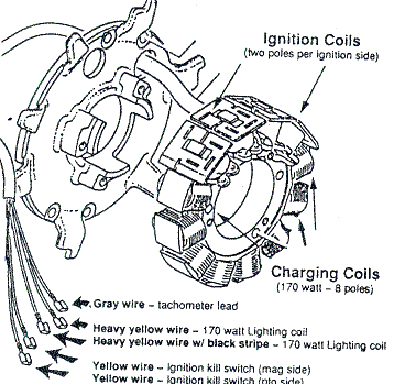

Postby Morph » Thu Jul 05, 2007 10:47 am
Here is a diagram
Moer details here
http://www.ultralightnews.ca/rotax503/w ... chdata.htm
Here is a wiring diagram

What he mean is that we tested the two sets of white and green wires leading from the loom into the motor. One set gives us 285 ohm and the other set is open circut. :roll:

If it is as you're describing it.........then sorry for you. Pull the flywheel and get to the stator. The green/white leads should have anything from 280 - 330 ohm resistance. In your case 285 is good. The other one is BAD NEWS :(
