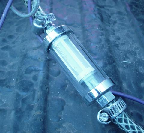

The “innocent looking” filter.
Genuine mesh size is much greater.

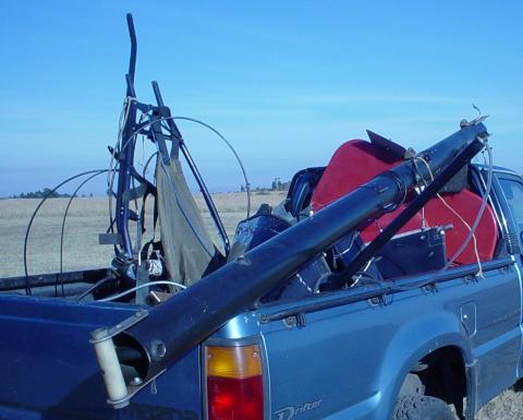

• One pilot wrote off his plane completely [see pics below].

The mesh on the “innocent looking” filter is just too fine. It is difficult to imagine it being able to stop a low flow of fuel. However, a definite restriction is evident when you blow through the filter.
I can expand – but I think that this tells the story.

The 'Innocent looking" filter in the back of his bakkie.
Plane written off for a R30 filter - is it worth it?

John Young wrote:The mesh on the “innocent looking” filter is just too fine. It is difficult to imagine it being able to stop a low flow of fuel. However, a definite restriction is evident when you blow through the filter.
And none of the above incidents are proved to have been caused by the filter's "fine mesh", or have they?
In my opinion, the end of the flat shaft that goes through the filter "could, maybe/perhaps/miskien" have caused a blockage by trapping fine particles of debris onto its sharp edges. The work-around is to unscrew the filter and use some fine sandpaper to round off the flat edges on the tip of the shaft that sits in the middle of the fuel flow.
There are literally thousands of Rotaxes flying around with these filters and they are by far the most popular filters sold in the US, by all of the reputable dealers and as far as I know, nobody has been sued yet :twisted:

John is right those filters are bad news. The only time I have ever had any fuel related issues and near engine out was because of one of them. I had cleaned the filter less than 5 hours prior to this incident. The mesh is so fine that it blocks completely with even the slightest obstruction. An electric fuel pump saved me that day.
