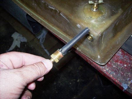

I have recently been told about a BB that had an engine out because of fuel starvation, because of a blockage in the petrol tank. To minimise the risk, a sieve MUST be soldered to the brass fitting that goes into the tank. The chances for al those 100`s of hole all getting blocked at the same time, is minimal. See pic.

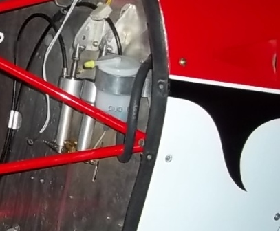

I use a rather large paper filter. GUD no: BC 31. It has a nice big filter area, so will not block up quickly. ( Note: This is for non prelube petrol systems!!)

Nice looking fitting. Not too easy to regularly inspect though.
Would a transparent inline filter not be a better idea?

Fuel tank outlet got blocked by dirt so with Boet's system it can not get blocked.

I have a particular distaste of these "fancy" in line filters, with the glas tube in between the two metal, chromed nogal parts. The actual filtering area is very small, and just a tiny amount of dirt will bring u down with a dead engine. As an AP I refuse to sign out aeroplanes without proper sized fuel filters. No compromise.

Boet is right , i also dislike and distrust those glass and chrome filters. Rather bet your butt on a GUD filter. :lol:

Pieter, net voor die firewall, waar ek n ogie op hom kan hou, elke slag as ek n pre-flight doen!! Watter soort "glas filter" het jy daar. As dit so n klein dingetjie is, groot swaar hammer en n moerse aambeeld. Daai kak hoort nie in n vliegtuig nie. :evil:

Postby Boet » Tue Aug 07, 2012 8:06 pm
Pieter, ek stel voor: Kry daardie fittings uit die tenks. Pencil grinder en gedult sal die job doen. Maak seker dat die outlets die siffies in het. Ek het al n paar van die ouer tenks onder hande gehad. Silver solder n moer met die regte skroefdraad aan n stukkie koper plaat vas. Skuur die area om die gat in die tenk skurf, en maak skoon met asetoon. Skuur die plaat met die moer aan ook lekker skoon en grof en maak ook skoon met asetoon. Plak dan die moer en die koper plaat aan die tenk vas met ABE Epidermix 375. Sit n lappie BID glasvesel oor en seel met epoxy resin of vynilester resin. Dit klink miskien na n mission, maar glo my, vir die vrede in jou gemoed, is dit die beste. Baie van die ouer BB`s het so deurgesluip sonder daardie BAIE belangrike siffies!!
