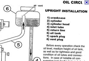

Pic attached - you see, if the bottle is the other way around, oil will only go to the valve if if it is full to the top..
My thoughts are this could explain some valve seizures ?

Postby nicow » Tue Mar 15, 2011 10:15 am
Thanks (^^) -I'll inspect mine.

Good day Gentlemen,
Please help, I’m new to this and would like to know
Just out of curiosity,
Who supply these little oil Bottles :?:
Eg. (Is this a Rotax specific bottle :?:)
What damage can come of this :?:
NL. (Inlet tube (4) and Return (5) changed around)
Must the Inlet (4) be connected to the bottom of the engine :?:
And the return pipe from the top of the valve to the bottle :?:
JHA
Re: 60% failure rate!
Postby Tailspin » Thu Apr 14, 2011 10:23 am
JHA wrote:Good day Gentlemen,
Yes this is a ROTAX specific bottle and you are looking at Ouchie price for Plastic bottle
Valve could sieze and ultimately the fan can go very quiet behind you and then OUCHIE on the Pocket.
Not 100% Sure but as what i can figure from the pic i would say the return pipe must be from the top of the Motor.

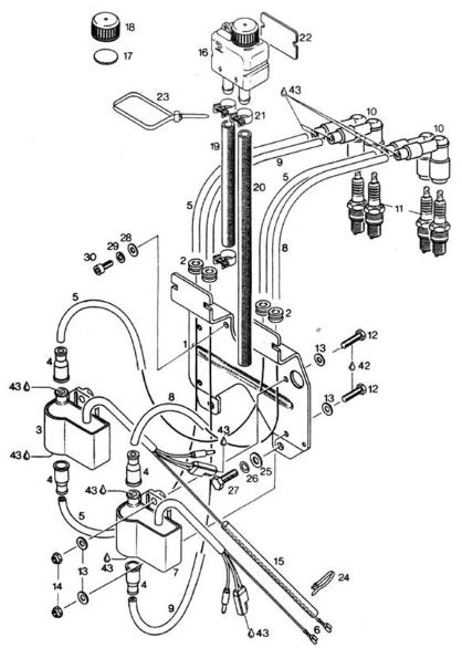

dont know if this will help or not...
ZU-DODO
Alkemac
Posts: 587
Postby Alkemac » Thu Apr 14, 2011 12:50 pm
sorry - wrong picture posted..my humble apologies! vhpy vhpy

This is the right way gents
No 4 to the bottom of engine
No 5 from the top of the engine
I'm sorted
Thanks Alkemac
jha
