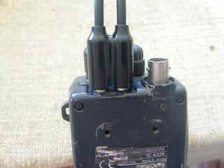

Dunesand, I have to be totally honest and advise the only fixes we are doing to ICA3 (22) radios now is fixing the sockets on the sides as they do come loose in service. The two sockets on the top which wear with usage we have made a boot for and have tooled for replacement knobs. These radios are now a minimum of 12 years old and spares are scarce. The UK uses them as they are about the only unit they can use legally. But here why bother ? You can buy a very good Vertex standard VXA220 from Cape Avionics and all the hassles just fall away. Sell that unit on Afors (UK site) and you will get good money for it that is if its an "E" series. A radio is a safety device and I dont think that this should be a compromise.
See the boot for the twin sockets. This fixes the wear on the small second pin caused by long cables of previous generation intercoms flapping in the wind. The pitch is set at 10,2 mm and is wider.
