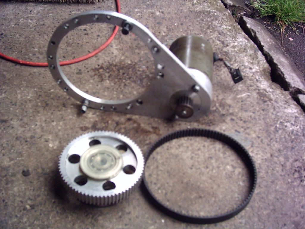

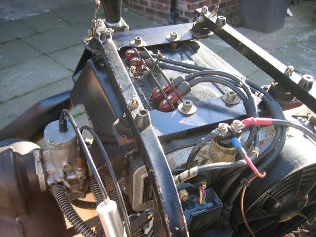

That sounds very much like the M4 or is it M3 starter I have on my 503 also belt driven through a one way sprag clutch on a trike with a 14ah batt,
I have some paperwork with it if you need any, the starter relay is quite small looks like it may have been off a motor bike...it was all fitted by P+M Mainair when my trike was built,
Pictures of my starter and the selinoid that should be able to see on the top of my fan housing.
Nick.
Nick.

This is exactly it, if you have any paper work in this regard, you have no idea how it would be of help to me, so I would appreciate it in more ways than one. If possible can you email them to garyheydenreich@vodamail.co.za.
Your starter looks exactly like the one I have and I am planning to fit it this weekend. How does it perform if I may ask?
Gary

No probs Gary I will go through my stuff and get back to you, it operates brilliantly with my 503....really spins the motor well...always firing up within a few seconds....I have had no probs with it, I do believe the motor is off a Peugeot car but I dont know which one,
The sprag clutch needs a few pumps of grease every 50 hours....thats about all you need to do once its fitted,
We have an agent for them here in the UK who I believe still does the spares for the M4 his number just in case you ever need it is 01257 450908 and its Eccleston Aviation...as I say its a UK number,
When you fit it make sure the bolts that clamp the clutch unit to the flywheel are not to long...if they are its possible for them to contact the mag coils ect under the flywheel and wreck them,
What a/c are you fitting it to???
Nick.
