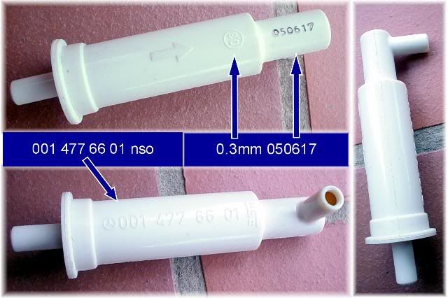

You need the Merc type filter and the part number if I remember correctly is BC69

BC69 is the GUD nr, just ask at Merc for the inline filter they use on the aero engines.

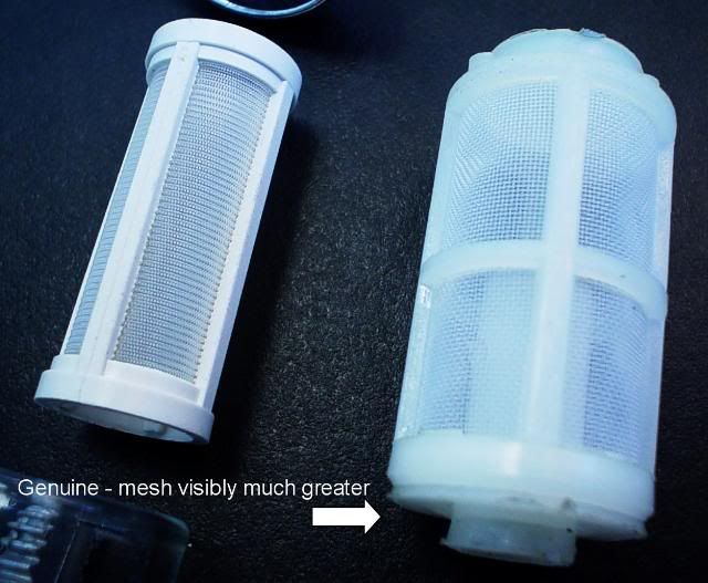

you need a 0.3mm mesh filter, no paper
The merc style filters are best, The have the right angle on the outlet

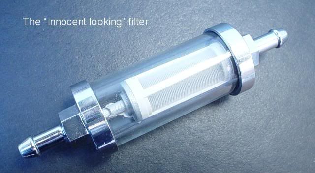

PLEASE DONT use the glass type with the filter you can see . Its CRAP...... nearly had a engine out because of it. Filter element is to fine and it blocks up and starves the motor of fuel. I only now use the merc type .. they are very cheap and i buy them directly form mercedes benz. Only time ive ever craped in my pants in flight !!!!! ## ## ## Cant remember the part number but i think it was for a merc W126 series.

wiskeyfoxtrot wrote:PLEASE DONT use the glass type with the filter you can see . Its CRAP...... nearly had a engine out because of it. Filter element is to fine and it blocks up and starves the motor of fuel.
Agreed !!!!

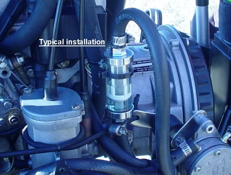

Postby John Young » Sun Dec 12, 2010 10:33 am
German wrote:your opinion on using the glass filter on ordinary fuel, ie not premix?
Hi,
Here's typical installation without premix. Found it on a student's trike just before going solo. The instructor could not blow through the filter and only engine cleaner seemed to unblock it. Why bother for R30.00? :roll:
