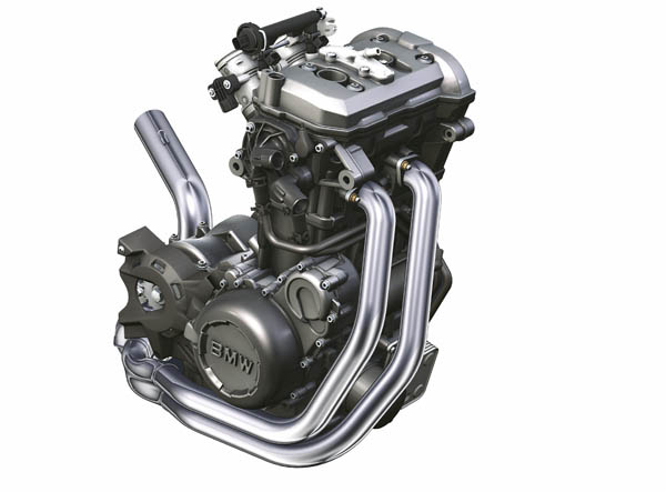

BMW did away with the single cylinder 650 Rotax manufactured engine, in 2007. This was replaced, in 2008, by a new parrallel-twin cylinder (also developed by Rotax), and features on the 800s race bike, 800ST (sports tourer), the 800GS and the new 650GS.
In the three former guises, the engine puts out 85BHP and 61lb/ft of torque. The peak torque curve is at 5750 rpm's and the engine really does come alive as you hit 6000 rpm. The new 650GS also features the same 800 motor, except that it has been detuned to 71bhp. This motor puts out 55lb/ft of torque and reaches the peak torque curve at 4750rpms.
The 800 S/ST versions are driven by a Kevlar lined, v-toothed drive belt and, in performance bikes, BMW suggests replacement at 40,000 km's at a cost of approximately R2200.00.
Our rental fleet runs the 650 Twins which, with the low rpm's delivering peak power, our bikes return consumption of 4.5 lts per 100km's vs 5.5 to 6 for the (high-power) 800.
These bikes are ridden hard and far but use little to no oil and have proven faultlessly reliable. The cooling system is efficient, even when doing slow speed technical riding in harsh sand environments which proves the engines ability in both cruising and varying load environments.
BMW's engine management system is legendary which allows the engines to run on some of the lowest octane fuels without damage and very little loss of performance.
BMW have also spent alot of time on making the new series of bikes lighter. The 650Gs engine is in fact lighter than the 800 due to a smaller flywheel. The compact size of the motor has also meant that BMW can deliver bikes to vertically challenged riders of 5.2.
We've had a couple of bikes written off. The engines have been untouched and I'm told could be available for between R16 to R20K per unit.
I certainly believe that this engine could be a viable alternative to the 1200 motor if someone were looking for a high performance, light weight and economical alternative.

Hallo!!I saw today the 650gs specs.I was wondering if it will work on my scout.71 hp is almost the same as a 582 ratax motor
These motor are bullet proof!One of my friends always ride the iron butts on his 650 gs.He replace the motor after 150000 km(frist motor) then he put the second one in and still going

That engine is in fact a rotax...

Soos stephan gese het. Die BMW 650gs engine is a rotax produk. As jy hom oopmaak staan daar rotax binne, en hy het 'n rotax crank shaft in. Vir dieselfde rede kan jy maar net sowel die 582 vlieg. Ek dink bradstof verbruik min of meer dieselfde, en as jy 6kW kan voel, is jy 'n beter piloot as ek. Dink in elk geval dat die 650 swaarder is as die 582, alhoewel ek nie syfers het om dit te bevestig nie, en dan sal die gewig die ekstra krag uit kanseleer.

Dit alles gesê is ek nie seker die BMW 650 is idiaal vir vlieg nie, omdat dit 'n enkel silinder is vibreer dit volgens my te kwaai (Ek ry een)
Die 2 silinder boxer enjins is die regte opsie en dis verseker wat ek volgende gaan gebruik

BMW het hulle 650 reeks opgradeer na 2 silinder engine. Jy het opsie van 'n 800 of 650cc.
My vergelyking het net gegaan oor krag. En vir daai doeleindes is die 582 en 650 baie vergelykbaar. Vir vlieg is daar net 5 aspekte waarna ek kyk. krag, gewig, brandstof verbruik, onderhoud skedule, prys.
Dit gese, behoort engines met dieselfde krag, min of meer dieselfde brandstof verbruik te gee. Die bmw beter agv die brandstof inspuiting.
Miskien om dinge beter te maak kan hermanator die gewig van die 650 vir ons deurgee sodat ons iets meer het om mee te werk.
Oor die onderhoud. CAA sal versoek dat 'n onderhoud skedule saam met die engine ingegee word. Hulle sal ook self hulle navorsing doen, en as hulle sien dit is n rotax crank, is die kanse goed dat hulle dit dieselfde sal hanteer as huidige crankshafts. Daar gaan baie meer moeite in om nuwe engine te gebruik as bloot net die montering op 'n trike. Hulle het al skedules van die 1150 reeks. Minder moeite.
