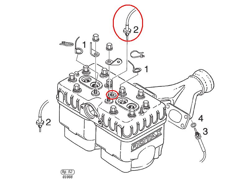

Duct tape is the easiest way of temporarily changing the water temp. But definately test the probe. You can take it out and dip it into a cup of boiling water, it should read close to 100deg C. You might need to drain a little water out first otherwise it is going to come pissing out of the hole in the top of the head.

Also remember that the gauge and probe is a "matched" (calibrated)set. You can't just put any probe with any gauge. Normally change both if you have to. They're cheap enough. You'll see if you buy a set as Midas or wherever, they sell them in a matched set. An unmatched set will give you incorrect readings, even though the actual operating temp of the engine might be right.ZU BBV wrote:Thanks Morph, will check the probe today. Had a good look at the temp yesterday. Goes up to 50 during flight. Must be the gauge.
