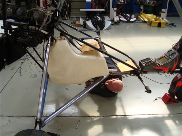

This is a concerning statement as the long range tank fitted has two feeder lines/tubes coming out as the tank is split where it fits over the root tube.i plan to put a fuel filter on each line before the Facet fuel pump imediately at the tank feeder lines exit from the tank.tandemtod1 wrote:, so by fitting the Facet pump and the extra filter is being unkind to your standard pump and it won't last as long as it should. A coarse strainer inside the tank and a fine automotive filter before the pumps is more than sufficient to ensure clean fuel flow. Sometimes, more isn't better. No critisism intended. We all do the best we can with the info that we have got.
Happy flying

Your concern is not a major problem as I didn,t mean to imply that it it won,t work or that it will shorten the life of the Rotax pump to an unacceptable degree.
If you have no other option, then fit two filters, and be aware that if the diaphram pump fails, then your priming pump can also do duty as a backup pump.
And for the people that keep telling you to put the filter after the Facet, Will you guys please stop confusing the issue, THE FILTER GOES BEFORE THE PUMP - THAT IS IN FRONT OF THE PUMP WHERE IT CAN DO SOMETHING USEFULL. I have said this so many times in my recent posts that it is getting monotonous and I am getting the impression that nobody is listening. Typing is hard work for us old fogies as it takes a long time using only one finger and I am beginning to wonder if it is worth the PT.
Now I have a question about your tank. If it is split to go on each side of the tube, then isn,t there a pipe connecting the two chambers together? If there is, then you only need one fuel line coming out of the top of the tank as the interconnecting pipie on the chambers will maintain the balance. If there is no balance pipe, then there should be.
Will you be taking your two pipe out of the top of the tank or the bottom? If they are coming out of the top, ie one dangling in each chamber, then be aware that the tank will likely not empty completely and not all the fuel will be useable. If they are coming out of the bottom, then connect the two pipes together with a TEE piece which will act as a balance pipe and then place your filter between the TEE and the Facet

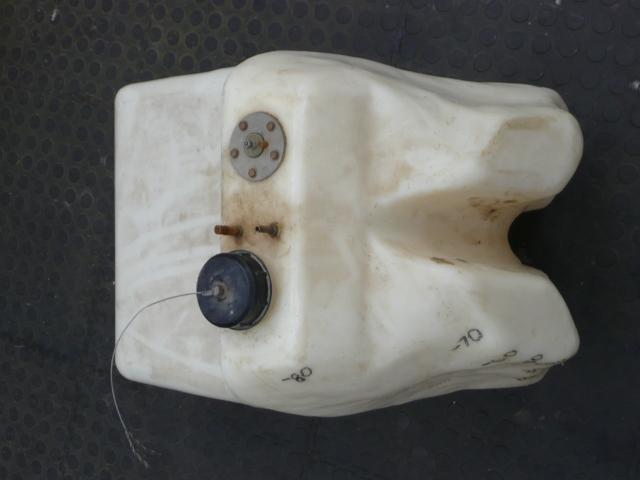

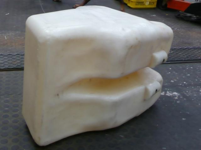

Heres some photos of tank
sorry not very clear but all i can resize to send..resizing wont #$%#$^ work today
I really dont want to cut and drill into the body of the tank..only 8 ever made and impossible to get new.
would prefer to leave and filter both outlets and make shure fuel never goes below 15 litres
I really appreciate your input and will implement where possible...Tandem todd im also a ONE finger typer
so i appreciate your one blister forming
Graham

another one i managed to resize..others wont work
