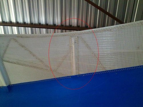

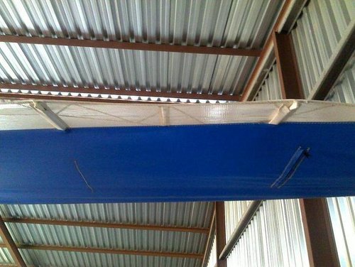

Hi guys.
I took a picture of the right hand side of the wing. In pic2, notice that in between the two battens, there seems to be a "slot" where something can be inserted. I am speculating, and might be wrong. Can anyone tell me whats the purpose of that opening.
Pic1 is a closer shot thereof.
Pic1 in the red circle is the area where I experience flutter. This occurs on both sides.
Wing has 240 hrs on and is about 10 years old.
The wing is situtated way in front at the hang point, but hands off cruizing is about 55-57 mph
regards
regards

See attached. Almost looks like there is a batten missing.

Re: Spirit 15 wing flutter
Hi Willie
It does seem like there's a batten missing on either side. On close inspection, that insert is too small to accomodate a batten. If you look closely on pic1, you will see that the actual "sock" that houses the batten is not the same as the one on either side, indicating that there is not supposed to be a batten. Something smaller in size?
My email address is: henkl@dywidag.co.za
regards
regards
Definitely looks like a factory job and the general design is different to mine aswell. Keep us posted but def looks like a missing batton.
Hi guys, sorry for the delay
I sent those pics to Rainbow but they still could'nt tell me what type of Spirit wing I've got. They recommended I fold up the wing and take it to them for further inspection. But interesting, one of our fellow aviators recommended I insert a small piece of arial wire (veer staal) in the "slot". And fantastically it worked 100%
The flutter is completely gone in that section.
Thanks Charlie Whiskey!
