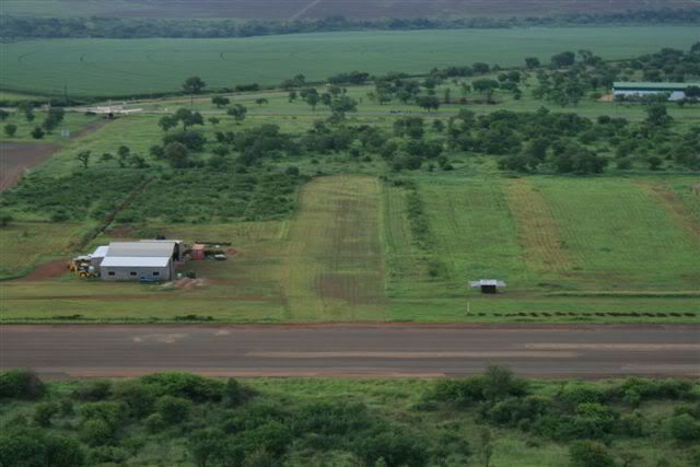

KFA is staging one for BB's (all welcome - why not pull a couple of Cubby's together?) ...Giarc64 wrote: .... would be nice to organize a cubby fly in sometime this year.
viewtopic.php?f=5&t=9468
He is clearing a large camping site - enjoy.
