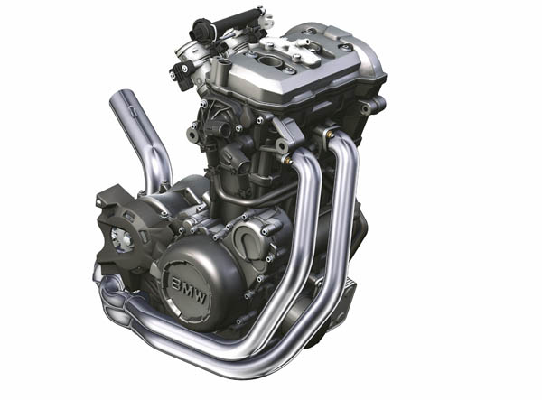

BMW did away with the single cylinder 650 Rotax manufactured engine, in 2007. This was replaced, in 2008, by a new parrallel-twin cylinder (also developed by Rotax), and features on the 800s race bike, 800ST (sports tourer), the 800GS and the new 650GS.
In the three former guises, the engine puts out 85BHP and 61lb/ft of torque. The peak torque curve is at 5750 rpm's and the engine really does come alive as you hit 6000 rpm. The new 650GS also features the same 800 motor, except that it has been detuned to 71bhp. This motor puts out 55lb/ft of torque and reaches the peak torque curve at 4750rpms.
The 800 S/ST versions are driven by a Kevlar lined, v-toothed drive belt and, in performance bikes, BMW suggests replacement at 40,000 km's at a cost of approximately R2200.00.
Our rental fleet runs the 650 Twins which, with the low rpm's delivering peak power, our bikes return consumption of 4.5 lts per 100km's vs 5.5 to 6 for the (high-power) 800.
These bikes are ridden hard and far but use little to no oil and have proven faultlessly reliable. The cooling system is efficient, even when doing slow speed technical riding in harsh sand environments which proves the engines ability in both cruising and varying load environments.
BMW's engine management system is legendary which allows the engines to run on some of the lowest octane fuels without damage and very little loss of performance.
BMW have also spent alot of time on making the new series of bikes lighter. The 650Gs engine is in fact lighter than the 800 due to a smaller flywheel. The compact size of the motor has also meant that BMW can deliver bikes to vertically challenged riders of 5.2.
We've had a couple of bikes written off. The engines have been untouched and I'm told could be available for between R16 to R20K per unit.
I certainly believe that this engine could be a viable alternative to the 1200 motor if someone were looking for a high performance, light weight and economical alternative.
