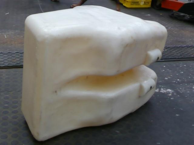

tank3 (Small).jpg (28.54 KiB) Viewed 2794 times
Hi Ttod n John
Heres some photos of tank
sorry not very clear but all i can resize to send..resizing wont #$%#$^ work today
I really dont want to cut and drill into the body of the tank..only 8 ever made and impossible to get new.
would prefer to leave and filter both outlets and make shure fuel never goes below 15 litres
I really appreciate your input and will implement where possible...Tandem todd im also a ONE finger typer :lol:

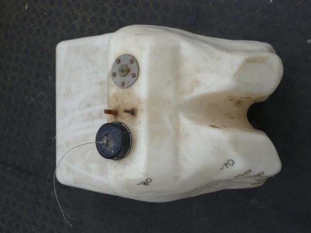

Postby Graham Mac » Sun Mar 08, 2009 3:58 pm
another one i managed to resize..others wont work

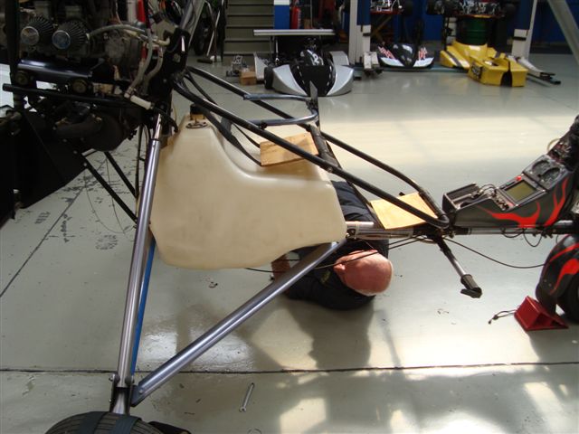

tank1 (Small).jpg (27.8 KiB) Viewed 2784 times
another one that hopefully gets the story across
confused now about filters before or after facet pump..only know that i will definately put filters before the diaphram pump
