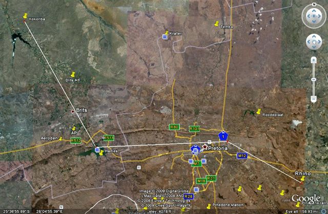

I include this picture just for some clarity.
Now, say one is flying from Rhino park to Kokoriba, via Hartebeespoortdam. We are mixing with GA on route, and not many of them know where Rhino is, and almost no one knows where Kokoriba is. We are using special rules east and west frequencies, which covers a very large area, therefore we might as well be flying south of Jo'burg according to ignorant others in the air.
Now questions:
Do I say CFW on route from Kitty hawk, our neighbours by 4 miles but well known in GA, to Brits A/F ? Now the route is known to many, but we might be expected somewhere where we wont be.
or
do I use Rhino and Kokoriba, stating current positions, so nobody knows the route, but at least knows where my last reporting point is.
and do we use the via Hartebeespoortdam option in the call, which becomes a very lengthy call on a busy frequency, but makes a huge difference route wise ?
If we route further to a private strip on a farm, say 30 miles north of Brits A/F, do we call to Brits a/f along the route, and from there on just call routing north from Brits a/f ?
Lastly, if I just fly around. don't know where I'm going to end or what my next turn is going to be, depends on what I see, how do I state my intentions, especially if there is not a major GA landmark nearby ?

There is no requirement to include your final destination in your initial calls, except of course if you are at a controlled airspace and reporting to the ATC for the first time
Rhino park is a formal field and should be used.
My calls would be "CFW routing from Rhino Park to Harties via the Pinedene corridor". However if you have to talk to JHB information then initialy I would give them the start and final destination
Once you are at Harties, then I would use something like "CFW routing from Harties via Brits to Kokoriba near Rooikoppies dam"
Use well known landmarks and call abeam airfields/towns etc once you are passing them
once you are above 1500ft agl then you have to talk to JHB information anyway
