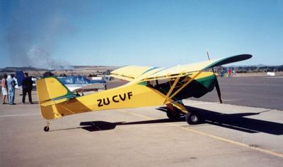

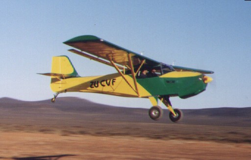

A guy at our airfield has one installed into a RANS S10. Because it is fuel injected he now can fly fully inverted without any problems. He does a lot or aerobatics with the plane.
As far as the engine goes, he has done 50 to 60 hours without issues except for the rubber coupling in the gear box shearing off. This turned out to be a manufacturing fault and this item is a standard used by all manufacturers, so it was not a Hirth problem
Here is a pic of the plane
