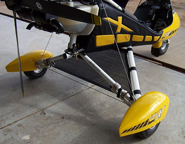

I forked out 8.5k for a new NC prop and it already has plenty small stone chips after only 40 hours
I also have the front mud guard on my Aquilla
Can only imagine what the prop will look ike in another 100 hours...
Aybody know where i can get this locally http://www.punkinheadair.com.au/accessories ?
And most importantly is it safe & legal? Will i have to file a mod report with CAA?
Thanks

hi Ant,
will this thing not add drag to trike?, check out Alex trike front wheel, he fitted a piece of rubber behind the front wheel, i think that would work better,unfortuantly you wont avoid stone chip completely, any other plans?

Hi BuksBUKS VAN NIEKERK wrote:hi Ant,
You're 100% correct I think very fine netting will add drag but wondering if one uses a type of netting that's not too dense (say 1cm squared!?) then it might be enough to at least deflect the stones away from the prop and still not add too much drag?
And I also have the piece of rubber behind the front wheel but it's not helping much, I have to add I don't actually have chips out of my prop but just lots of small scrapes/cuts which I'm sure will get worse over time
And most importantly does anybody know if I DIY something will it be legal / will the CAA allow such a thing?
I can't get hold of Solowings for some reason phones just ringing eish!?!? Would be nice to get their take on it............

Hi Guys,
We fly from Panorama and had the same problem on some our friends trikes! Especially an Aquilla and Raptor, both fitted with the stone guards on the front wheel! After 3 prop blades we tried removing the actual guard and the problem was sorted!
Problem was on landing and take-off's, that with the prop pushing on take-off it actually makes the guard touch the surface and by that picking up extra stones than just the tire and hitting the prop, on landing obviously when the front wheel touches down and on braking!

Ant, I would not modify the Aquila front spat. It has been optimised by the factory.
If anything, Rhino's runway is reasonably newly tarred, and small residual stones may still be left behind. Do an on foot runway inspection and have it swept if "dirty". Please let me know when you are doing this so that I can look out for the sniffer dog..
The up side is, small nicks, AFAIK, are not structurally dangerous,... just ugly.

Almost every trike in Oz uses the stone guard.anthonyhugo wrote:Hi guys
Thanks
Ant
I have not found any drag or unstable characteristics by using one.
The front wheel is what throws the stones up

Thanks I still havent given up completely on the idea, spoke to CAA and they require model/serial numbers and full details before they can issue a mod reportMc Guyver wrote:Almost every trike in Oz uses the stone guard.anthonyhugo wrote:Hi guys
Thanks
Ant
So it will be tough to get a DIY stoneguard approved
Perhaps I should import some and then try get formal CAA approval...
Do you know if the Aussie companies make these for Aquilla trikes?
Ant
