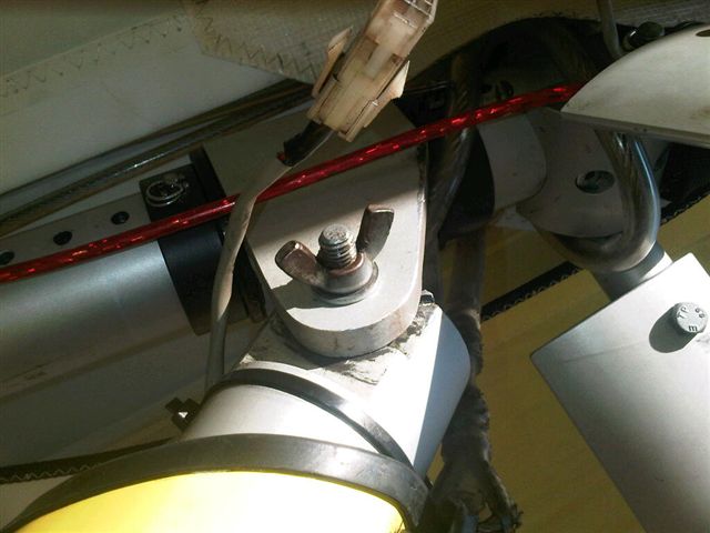

What is wrong in this picture?
Asterix
Posts: 637
Postby Asterix » Wed Apr 11, 2012 6:14 pm
No prices for the winner!

Re: What is wrong in this picture?
Postby DarkHelmet » Wed Apr 11, 2012 6:56 pm
There is no retaining clip on the wing nut
DarkHelmet
Posts: 2046
Postby DarkHelmet » Wed Apr 11, 2012 6:57 pm
That the J-bolt! eina!
Postby Asterix » Wed Apr 11, 2012 7:19 pm
Yes, Darkish one, you win the price! ( No cash though, just bragging rights!) One would expect the professional who rigged the wing to pay attention to such little details? Before informing you that your trike is a-okay and ready for collection?
Apparently not. But I divulge - I do not believe in smear campaigns! :wink: :wink:
On a "pre-flight" note to all trikers: Remember TO COUNT YOUR CLIPS!! ## ## You can fly the most beautiful / well-kept / stunning / loved / yellow :wink: / plane, but one little missing piece of twisted spring steel can lead to your demise..
Wing separation - easily achieved once the wing nut passes the little hole that was supposed to stop it!
NS: These wing nuts all over a trike (with their respective clips) were made for people who want to de- rig their trikes and trailer them down to where ever: - there to fly and look cool. My take: It has a wing, it can fly, so why trailer it? FLY IT!
I think I am going to replace all those loose wingnuts with proper nylon nuts. I'll keep the safety clips for show. ## ##
