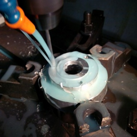

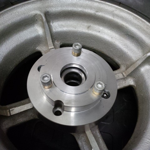

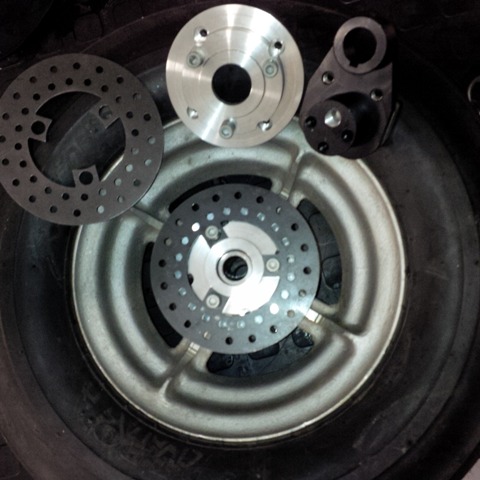

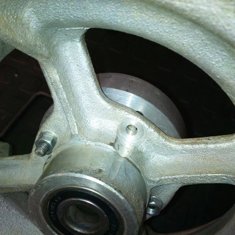

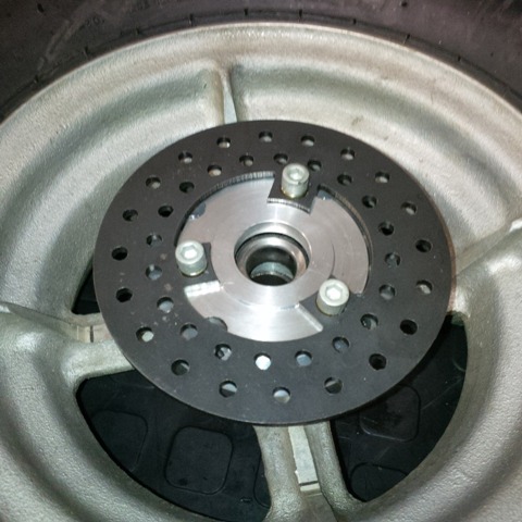

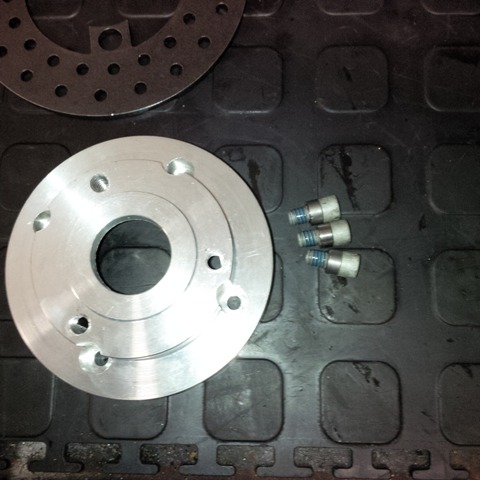

also an update for you -- got Tony's wheels and spats with me, today CNC machined the adapters, mounted the discs, and calipers, tomorrow machining the shaft insert and spacer, then small mods to the knuckles and the kit will be finished.
1) we blasted the knuckles from Tony's Cheetah (nice and clean!)
2) dissassembled the drums from the rims
3) machined the adapters from billet, and the spacer and shaft insert
4) lock tite the three cap screws that the brake disc floats on, bolt them into the adapter
5) basic assembly of the parts and spatts as a unit
6) install onto the plane (knuckles onto the support beams/struts
7) Bleed brakes --
Job Done
some pics in the mean time (better than the previous phone ones)
7) Bleed brakes --
Job Done
