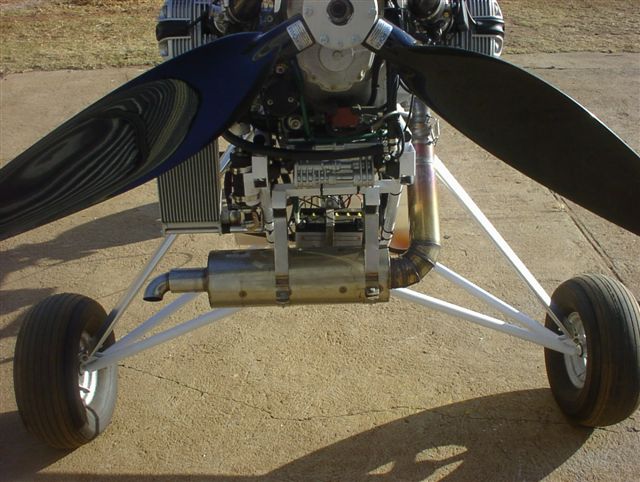

I did the installation of this brand new BMW 1100cc / 100Hp on this raptor.
Manfred Springer did the mountings and brackets.
It runs on a digital fuel injection (BOSH DME ) and it uses 7.4Lt per hour.
It has a electronic altitude compensator for the ignition timing and fuel mixture. we have had zero problems since instalation.

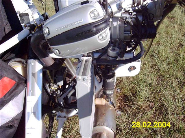

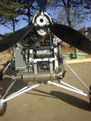

Some more pics

Hi mike , what box are you using , I have an option on a complete bike , but the box is still the issue - Local is lekker

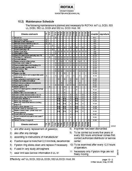

I have attached 2 pages here. One is the one being referred to above and is clearly from the 1994 version of the manual, check the date bottom left, and the second from the current May 1999 version of the manual which IMHO supercedes this old version.
You will note nothing is mentioned in the 99 manual at all regarding the required crank change.
Now, have suppliers deliberately stuck to an older version of the manual in order to move more cranks :?

Mike
Yes man... that's the kind posts & pics we want to see.
There is life after BRP... I like the fuel injection option.
Maybe get a new 1200 uprated motor from a wiped out bike and then do this conversion! Drop the pipes out and fit an Akrapovic or Two Brothers!
Man, this can work!
Will get in touch with you!

The box is a sliper cluth type and is made by TAKE-OFF in Germany.
They use these motors for trikes,fixed wings and hovercrafts.
