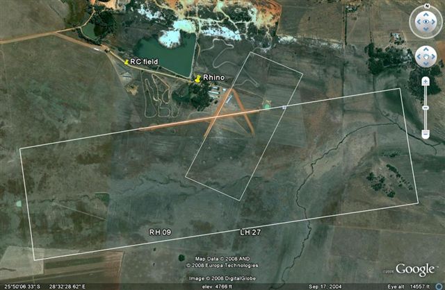

I'm more asking than stating.
In the airfields guide, which is more readily available to us weekend warriors, it is stated that no circuits are to be flown to the north of the 09-27 and to the west of 03-21 the smaller circuit on the pic, which are rarely used - then I would presume there is a valid reason for not flying there. If you approach the field, the RC field is very obvious, and that should be the reason then.
I've added this pic for infos sake. The Rc field is 450 m from the threshold of 09 - safe distance by me, and they fly to the north. If you have a look at the circuits that I have added, and the position of the RC field - to go flying there, is looking for trouble. Even if you do not know the field, to go to Rhino park you should know not to fly to the north of the field.

Postby skybound® » Fri Oct 10, 2008 10:22 am
Nice diagrams Ldel. There is no fault in your thinking and is exactly what should be published for that field. As it stands using your pattern it would mean that a pilot would effectively be breaking the law by flying them. Standard circuits are left hand circuits - unless published otherwise or told by an ATC to fly it otherwise.
Playing devils advocate - say a pilot joins left hand and another on right hand. In the event of an incident/accident the one flying the non standard circuit could be the one deemed at fault. So one is really faced with the decision - do I take on the possible mid air with a model or do I break standard procedures - both can have undesirable outcomes.
Perhaps time for the stakeholders involved at Rhino to get involved - maybe we are missing something. If not, then perhaps time for aggrieved persons to file a CAHRS.

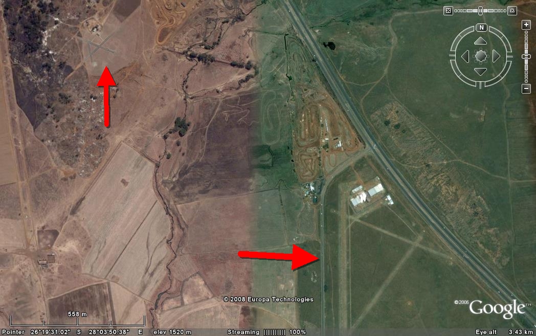

Postby John Boucher » Fri Oct 10, 2008 4:30 pm
This is my dilemma at John Weston. :? The large tar circle is not a helipad but the R/C club! It's in the middle of everything ..... really not good. :shock:
The other fields one could quite easily sort with the correct circuits, circuit heights and joining procedures :idea:
