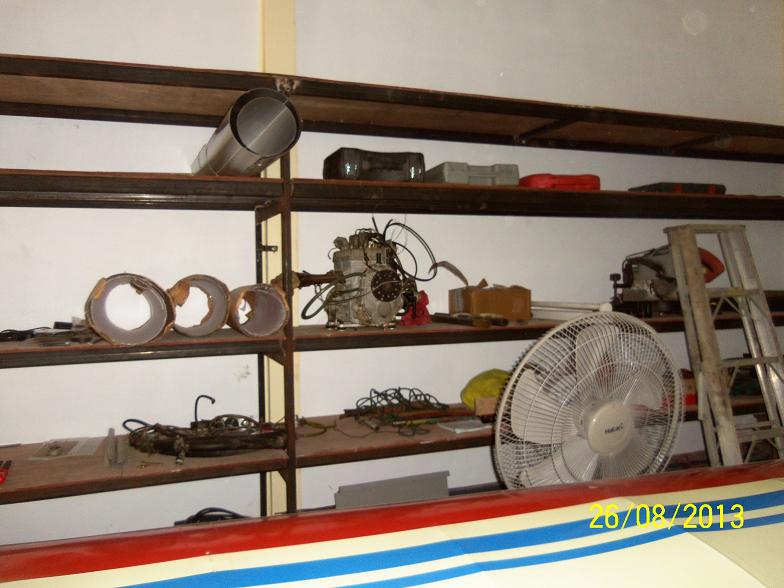

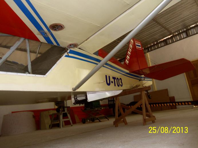

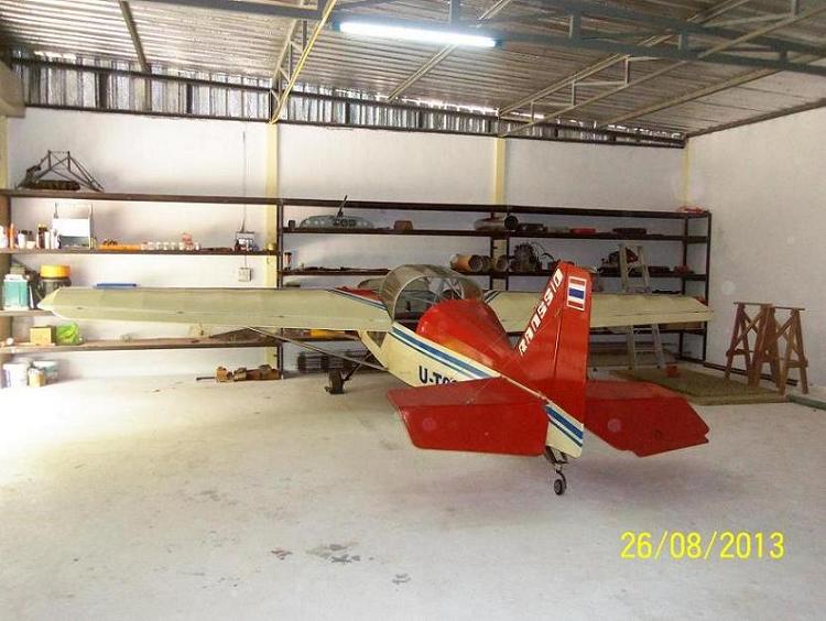

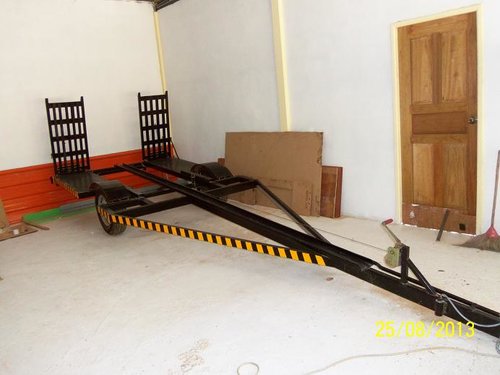

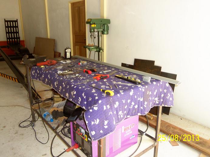

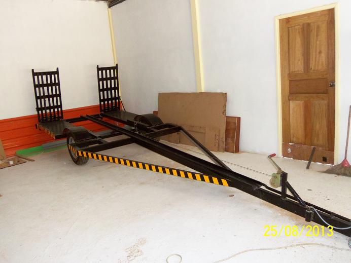

Parts and material arrived 3 weeks ago,in the mean time I build a hanger and a trailer for S 10.Making shelves in hanger paint the floor manufactured tow bar for TaTa.
Trailer for S 10

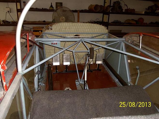

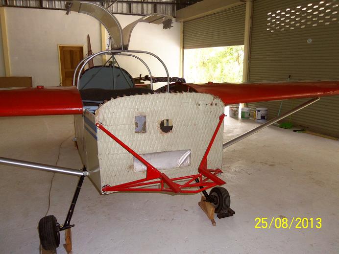

So about 10 days ago I start on the S 10 stripped all old parts out and repaired rusty areas,
Installed new trim cable, new rudder pedals Matco brakes made up and installed lift struts also install radiator and water lines. Also new engine mount for 912 engine.
Rudder and brake pedals.
Engine mount
Lift strut
Radiator and scoop.

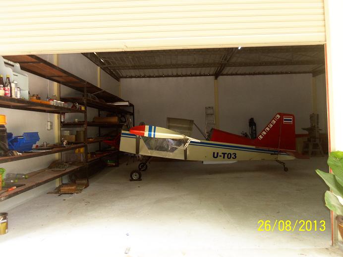

Rans is parked now I am on my way to work again for another four weeks. First one hour flight to Bangkok then 3 hour flight to Jakarta then three hour flight to Matak helicopter base in a company plane a Dash 8 then one hour in chopper Skykorsky 76+ Then my destination metal island in the sea rig Wildcat which is my second home.
I post a few pictures.
Rans S 10 parked.
From the left side.
The 582 engine.

That Rans really looks good (^^) (^^) (^^) Thank you for the pictures vhpy
Sorry, I must have missed the 912 engine installation and the obvious placement of the cooling radiator. The 912 is heavier than the 2-stroke hence the balancing trick.

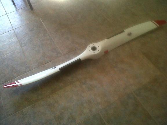

I am in contact with Ernesto from Argentina he is the leader of their acrobatic team they got 12 Rans S-10's !
I bought some parts of him intake manifolds and oil system ,will buy a prop too from him . Made in Argentina.
The prop is special made for S10, it is a wood prop
covered with fiber glass and the leading edge is covered with stainless steel. $850.00 for one.
This prop give the Rans very good performance in all kinds of maneuvering.

Picture of prop from Argentina.
Prop for Rans S- 10
