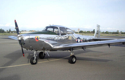

Thanks alot man - i will certainly keep that in mind. but i must say here is a pic of a REALLY NICE Navion, which has my brain ticking in the same direction....

Postby John Boucher » Wed Jul 16, 2014 11:10 pm
No that's a clean design... I like it!

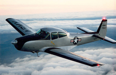

Thing is it might be considered an insult to some as the ARMY never used this plane in RSA - it was actually flown by Oom Willie (Mr Navion) to south west and back for dignitaries etc....
here is another design i also quite like - but cannot make a decision!
