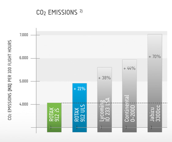

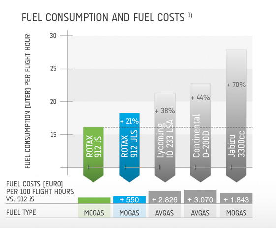

I smell a serious rat with those economy figures...
Firstly, by book figures, the IO233 is more economical than the 912ULS, and the rest are about the same as the 912ULS. In fact, the Jab 3300 tends to use fractionally less fuel than the 912ULS, in the same airframe, not 10l/h more.
Secondly, if the 912is really is 21% more efficient than the 912 ULS, then the carburated set up must really suck - seeing as the theoretical improvement should max out at around 15%.
I get the feeling these numbers (if they are real), are taken under some extreme worst-case scenarios to try and make the 912iS look like it is worth the extra 45k...

OK - I just looked up the references Rotax used for those charts... They DO mix fuel consumption figures from completely different performance points - what they present there is a truck load of horse manure...
Just for a laugh, I used the same sources to calculate BSFC at 75% power:
O-233 (injected) = 0.27 l/hp/hr
Jab-3300 (carb) = 0.288 l/hp/hr
912iS (injected) = 0.3 l/hp/hr
Yup, believe it or not, the 912iS (according to the same specs they quote) is the LEAST fuel efficient engine of the lot! (NOTE: it seems the fuel consumption does taper off quite a bit below 75% power - it seems the 912iS runs substantially rich at 75%...)
Also, the published performance data shows the traditional ~3%/1000ft decrease in max power - the same as every other N/A engine out there...
