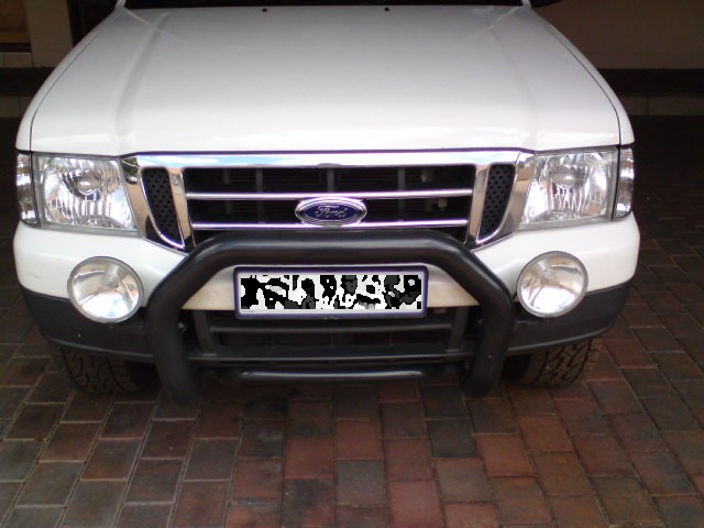

At the same time that they fix that headgasket let them remove that CRD chip. Let me guess - it's either one of the ford/mazda 2.5 turbo diesles or a colt 2.8 turbo diesel?.
Aerosan
Posts: 1133
Location: Krugersdorp
Re: My Luck...or lack thereoff......
Postby Aerosan » Thu Feb 05, 2009 2:35 pm
Yip, CRD chip on a Colt 2.8TDI.. Why should I take it out :?: not looking for an argument just want to know and make a good decision :wink:
Stephan van Tonder
Posts: 1376
Postby Stephan van Tonder » Thu Feb 05, 2009 3:03 pm
Colts have a history of blown headgaskets. It comes from 2 places - either the vehicle overheated at some point or they turn the fueling and boost up so much that it's past the point of where the engine falls in the live happily ever after area. On diesels when you add fuel only your combustion temps go through the roof. So you have to add boost. Now depending on how much of each they did you can sit with a situation where your engine is not a happy camper. So in any case - if you don't take the chip off - get yourself a boost gauge and install egt in the manifold pre-turbo. Realistically you should not see more than a bar boost(which is already quite bit) and not more than around 700 degrees celcius EGT before turbo. If you are over those specs best you be ready to spend a lot more money on that engine in the long run. Sadly CRD in my books does not have a very good reputation. I have seen them screw up a couple of cars.

It makes perfect sence :!: I do now that it overheated before I bought it and so that would ring true :| anyway it was my intention to install both the boost and the EGT in any case so that is a good idea then. vhpy

.......and move the spotlights, like in the Ford. I have my second Colt now. Great bakkie, but eeeish, that spotlights in front of the radiator, she does not like.
In later models they actually came without the spotlights.

Postby Aerosan » Fri Feb 06, 2009 5:15 pm
Ill move those spots 8) I can see the logic behind it the last thing I need now is more overheating :!:
