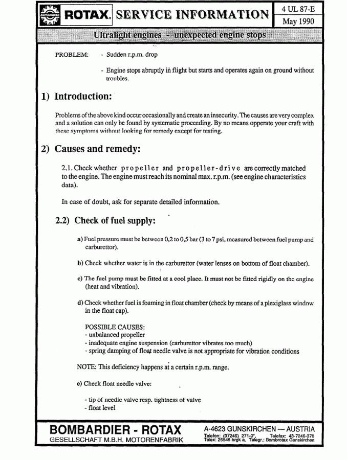

Here's something else you can look at.....
