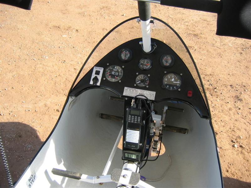

Hey Dog Man. Please post some pic's of the mounted 196 when done. I have one that I am going to mount as soon as I have my trike back here with me. I do not have too many options though, they are pretty big. I am going to relocate my radio and mount the 196 in it's place. I will have to make an angled plate to mount the bracket on though.
Any thoughts? Anyone
Sorry for the highjack.

I would move the REV counter to make way for the 196. This would require you to change your whole panel though. You have so much space if your instruments were grouped more economically...

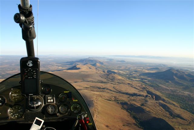

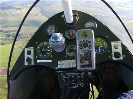

Fitting 196 to AIrborne I would use RAM (the best) U-bolt mount - Should fit onto Airborne's front profile tube as it is small and round unlike Aquilla - This lifts the GPS above your instruments and would work great I reckon
Picture attached of my Gemini where I used this U-bolt mount to fit a Garmin 72 to the front profile, worked like a charm.
Also attached a picture of where my Garmin 96c was fitted to my Airborne - 96 much smalkler than 196 though
If the u-bolt does not quite fit around the Airborne front profile (it should though I think) it can be bent a little to make it fit around - It is normal steel bolt in shape of a U and can be bent to fit around the front profile tube
The model number for the RAM U-bolt with yoke is RAM-B-149-GA7
I will post pics after the 196 is fitted to my Aquilla for interest sake - But doing it a little different there
LEt me know if you want to go the front profile-route, there is a Airborne in my hanger (MaverickSA's) and we can test if U-bolt will fit and let you know before you buy

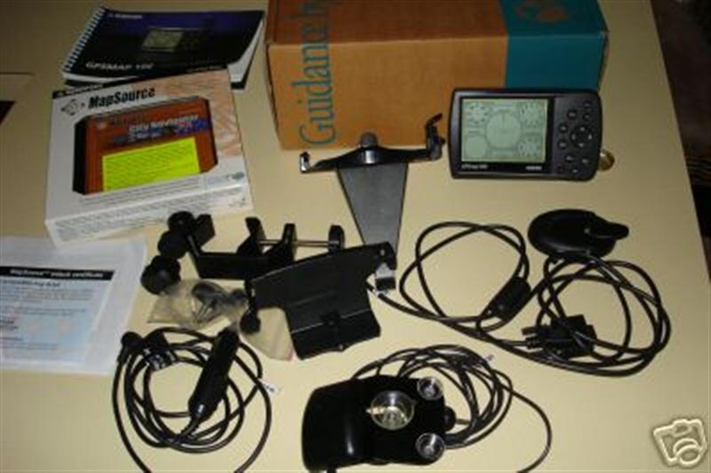

How do you suggest I get power to it. The silly little lighter socket that Airborne put on the left is not big enough for the regular plug.
I am probably missing something somewhere.
Here is a pic of all the gear that came with the 196

Cali, that lighter socket is called a Hella plug I think, you get a connection that changes it to normal lighter plug - I did it on my Airborne
- Got adaptor from Darkhelmet but should be regularly available
