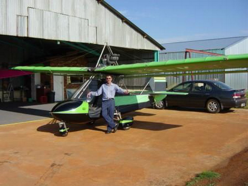

- How she looks now - a little dull to say the least - but she's gonna receive some serious makeup...
- 131_3105_img_207.jpg (87.04 KiB) Viewed 3744 times
- This is the very minimum I want to streamline her to - add to this spats & also a better wing profile
- 131_3128_img_136.jpg (85.76 KiB) Viewed 3744 times
- Although not my choice of colour, this shows how much it effects the overall looks - Does not look like a Mizer anymore!
- Mizerc.jpg (94.53 KiB) Viewed 3718 times

Hi Slider,
Thank you for your response. However, I've already negotiated a deal for a more powerful engine for her. Rotax 582 comes off this weekend and Hirth F30 will go on soon.
I know about all the negative publicity these Hirth engines received, however I'm willing to take the chance as she can really do with the extra power. If everything stated on this forumn is true, the 582 is prone to crank breakage so I'll not really loose much reliability. (She flies beautifully as is, but climb is not too hot with two aboard (500fpm) - if this works out she'll climb and take-off like most trikes)
I had to make a choice, sell and buy something more sophisticated or upgrade. I like just about every aspect of my Mizer - if she can perform better and produce less drag, she'll be everything I've dreamed about owning.

If she was mine
The elevator trim on WOG, with that huge tab, is k@k. I would look for something better. The origional had a bungie on the joy stick.
I would also look at a better wind shield (the "shark" looks like a good option.
See if you can add a space for luggage (maybe above the fuel tanks at the C of G??)
Add spats only if you want to prevent mud/stones being kicked up.
For all the above consult an AP.
Re-cover her in some subtle colour scheme (like Pmarshal's Cheetah??)

Hi Griffin,
1. The spats will go on - have them already
2. Windscreen will be like sharkey's - decided that long ago
3. Luggage space is a good idea as she will now carry this weight easily
4. Yes, trim tab will change to much smaller version & on one side only.
Actually starting to look foward to all of this although it means that I'll be out of flying for a while.
