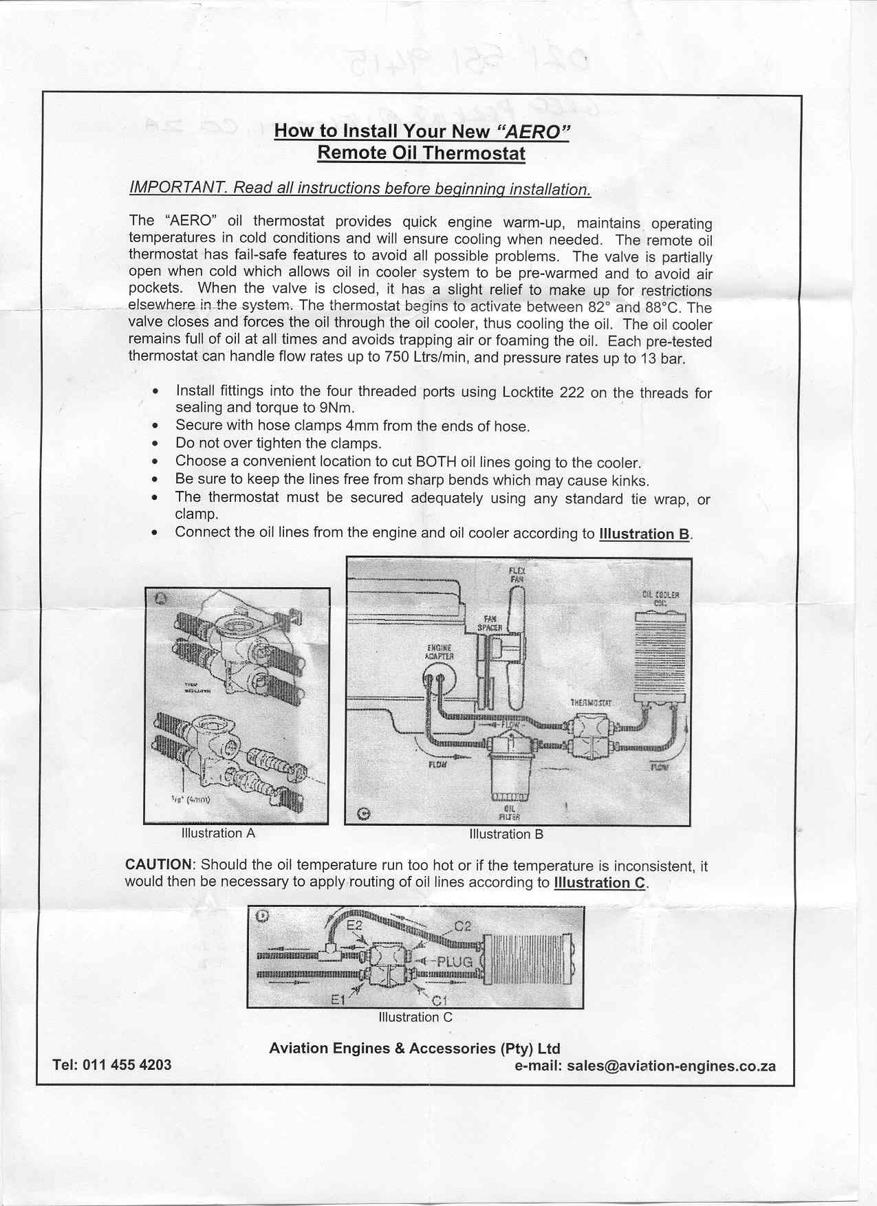

Does anybody have installation instructions for the 912 oil thermostat.

Hi Morph
I have the instructions in front of me.
No T or Y piece required for the 912 installation.
Thermostat has 4 ports as you have drawn it, 2 in and 2 out. 1 in and 1 out on each end of the thermostat.
Cooler bypass occurs in the thermostat itself.
Do you have the thermostat and instructions yet?
I can scan and email you the instructions if you wish. Call me on oh82 41 ooo82.

Thanks Mogas, I got given a thermostat but no installation instructions. If you could fax them to me on 021 551 9415 or scan and email them that would be great

Postby Mogas » Fri Oct 26, 2007 11:28 am
Sorry Morph
Had a power cut :evil:
Back online now. Will scan and Email.
By the way drawings are for auto installation, adapt illustration B to suit.
Installing Oil Thermostat.jpg (182.44 KiB) Viewed 1296 times

Postby Morph » Fri Oct 26, 2007 12:02 pm
Thanks Mogas
I put the pic under your response so others can reference it
