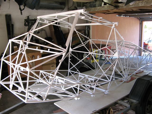

Postby Morph » Mon Jul 23, 2007 3:41 pm
Yes, the welding shop has to be an aviation approved welder. The Bush Baby is built in a jig and mig welded. It is a very neat job.
Monty at the BB factory also does do welding for non-BB clients as well (or he used to). He would be the best person to speak to and maybe he can tell you where to get/supply you some tubing.
The airframe is made up of a lot of triangular sections to give it strength. You must powdercoat it to protect against rust
This is my airframe
call him on 0ate2 seven54 340four
BTW what are you intending building :?:
Powder coated frame.JPG (81.7 KiB) Viewed 3944 times

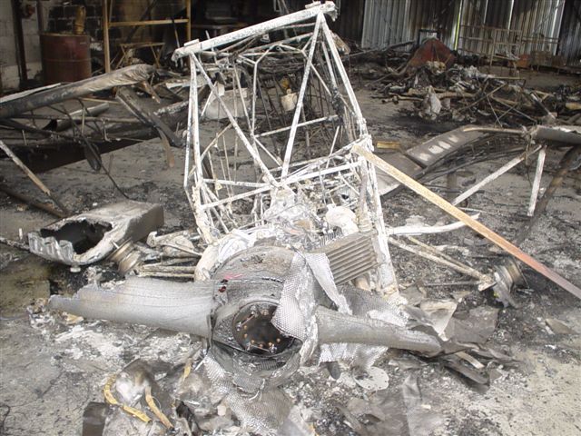

John Young
Posts: 1973
Postby John Young » Tue Jul 24, 2007 6:39 am
Morph wrote:The BB is not the first plane to have a steel frame. It's been used for years. The Piper Tripacer/Colt is a steel tube and fabric plane and so is a Pitts Special
The Savage also has a steel frame as can be seen below.
John ZU-CIB
Before
After
