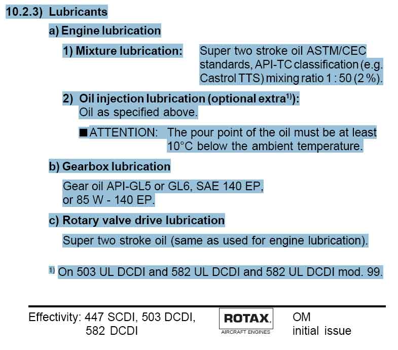

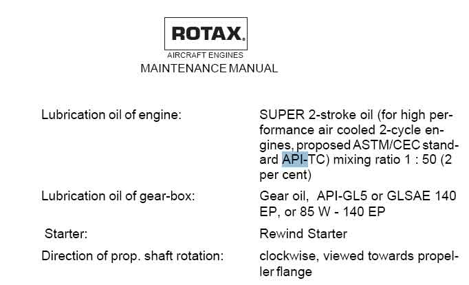

I've got a Rotax manual in PDF, it's for 447, 503 and 582 Silver and Blue, it's only got one section for lubrication. Now I'm confused...
Operations manual
Maintenance manual

Postby Morph » Thu Jun 28, 2007 9:39 am
I agree, clear as mud
Using a higher temp oil i.e. the Super Chainsaw in a 582 would be fine. Just don't use the outboard oil intended for lower temp water cooled engines in the hotter 503
