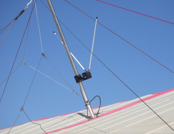

The skill is the switching circuits as the commercial radios are a three wire set up as the mic is wired in series with a 2k2 ohm current limiting resistor which activates the PTT. The Aviation radios Icom and Vertex are much simpler with a four wire set up. I have a option in our existing chatterbox to do this also which is a heap smaller and ideal for farm usage, It monitors both radios but switches manually to operator choice. The music also mutes automatically with either line in (or ptt press) and fades back in with a time delay.
If coupled to our Vee rabbit antenna makes a perfect small farmers comms set up. See pics of our King post antenna on Oddballs trike. This was used with a ICA 23.

- Vee Rabbit.jpg (84.76 KiB) Viewed 3050 times
