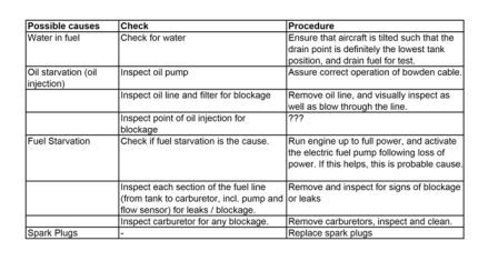

Guys, thanks for the advice so far. I will conduct a systematic inspection next weekend, and keep you posted.
Personally I still feel that fuel starvation is the cause. I base this on the fact that when I simulated this and cut the mags the moment the power loss occured, it resulted in almost empty carb bowls.
I have compiled a checklist. Please advice if you don't agree, or have other checks to add.

ANDTjoek wrote:.... I found that the carburetor bowl fuel levels were on the low side.....
Tjoekie....you speak with forked tongue manTjoek wrote:....it resulted in almost empty carb bowls.
If the latter be the case, and you say you recently changed the fuel lines, then start by checking the pulse line (that's the one from the engine to the Mikuni fuel pump) If you have changed this, then make sure that you have replaced it with a good quality fuel line that doesn't have a too small wall thickness. The suction from the engine can suck this closed or partially closed.
Check all the fuel lines to see if the clamps are not too tight and that they haven't pierced the pipes which can cause a leak.
Also check your fuel pick-up inside the tank for debris that could be blocking the pick-up.
If everything checks out.....remove the exhaust manifold and check the condition of the pistons through the ports. You'll soon see whether it had suffered a seizure if there are score marks on the pistons
