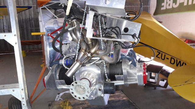

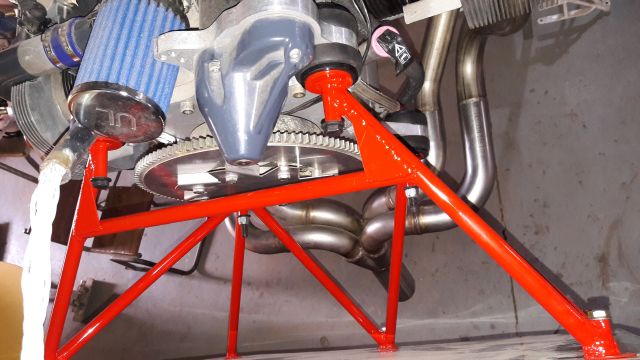

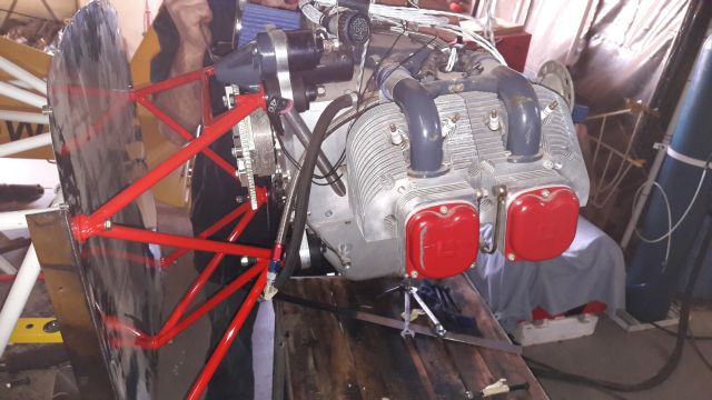

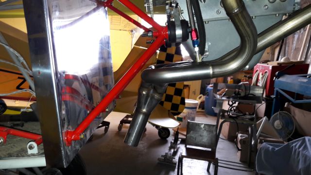

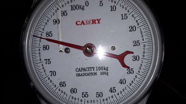

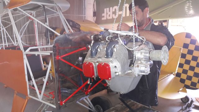

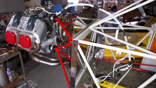

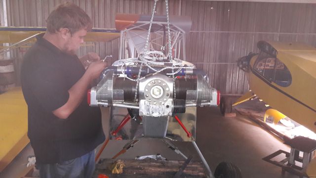

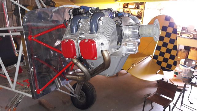

Here are some photos of our recent progress, enjoy ! As mentioned this is the installation of the UL Power 350i engine of 120hp.
Jean.

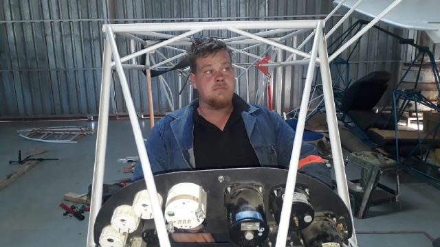

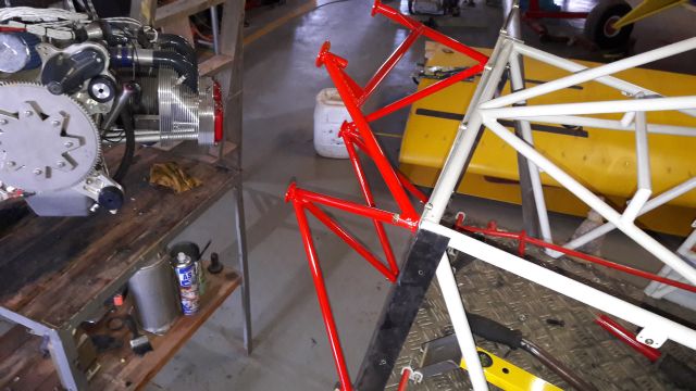

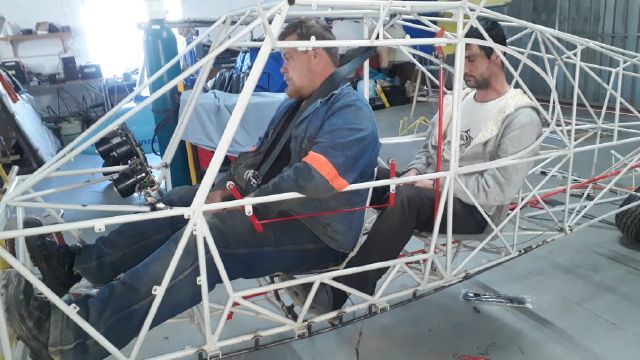

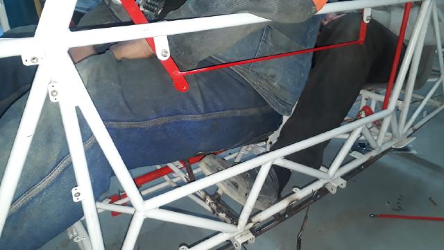

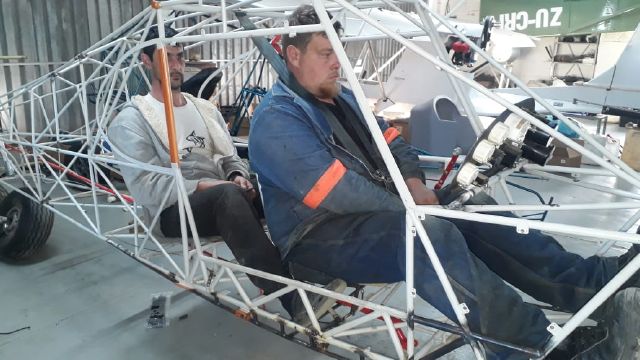

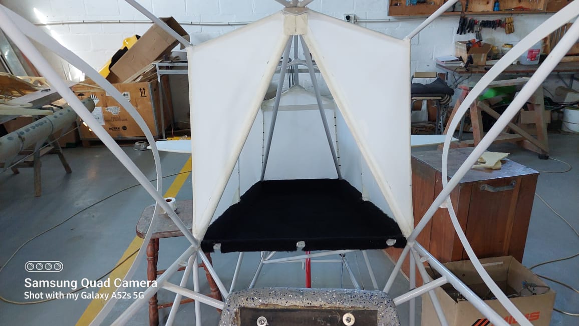

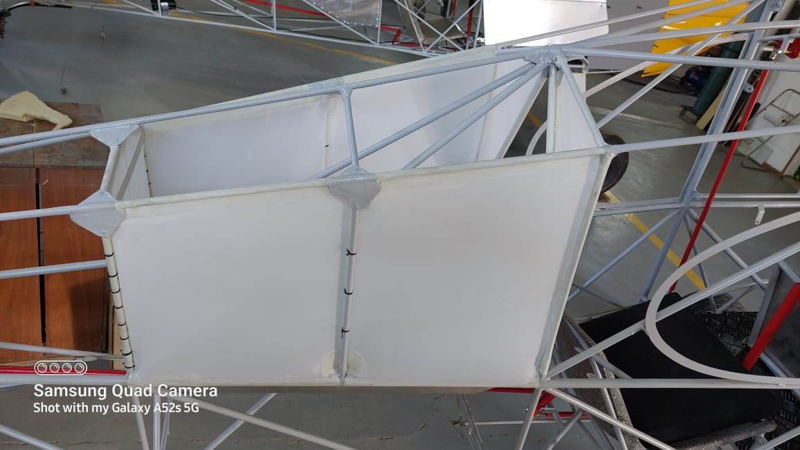

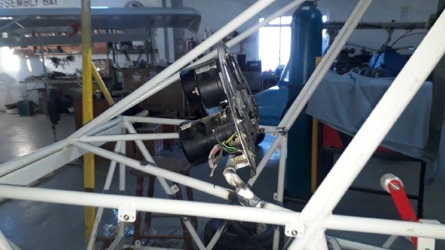

Here are some photos to show what exactly we have been up to with this Renegade frame. Basically it is a couple of ergonomic changes to improve pilot comfort. The two "test dummies" are both over 6 foot tall. Joos, the burly one in the front seat is 6ft 2, and Pierre the more slender one in the rear seat is 6ft 1, and has a size 10 shoe, note the position of his feet.
1) The instrument panel has been moved foreward, now tall pilots have more "knee room".
2) The position of the rear occupant`s rudder pedals have been moved away from next to the legs of the front occupant.
3) Toe brakes will be used for both front and rear .
4) The door frame has been made bigger to the front to facilitate those pilots with less "bendy" joints.
5) The front seat frame also got a bit of an adjustment, notice the good headroom for those "grain fed South Africans" :lol:

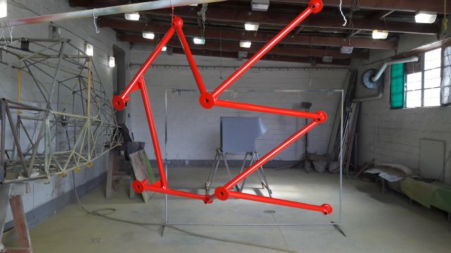

Postby Jean Crous » Fri Jan 22, 2021 7:09 pm
vhpy We have an order for a Cubby Maverick (previously dubbed MK2). We are in the final stages of welding the airframe together. This frame will be brought up to the same phase as the Renegade frame, which is ready for assembly, then we will be building the Renegade and the Maverick simultaneously and will post photos as we progress.

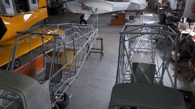

Postby Jean Crous » Mon Feb 22, 2021 9:59 pm

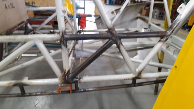

The Cubby Maverick frame is done welded, we finished painting the frame today. Next week we will start the Renegade and Maverick builds alongside each other, and take "time lapse" photos as we progress.

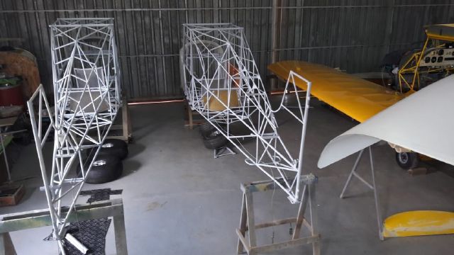

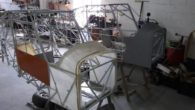

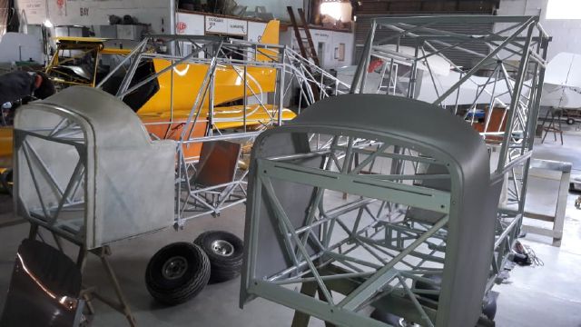

Postby Jean Crous » Wed Feb 24, 2021 4:15 pm

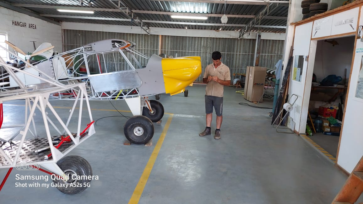

Renegade and Maverick airframes next to each other. During the build of these two aircraft the differences will become quite clear.
Jean.

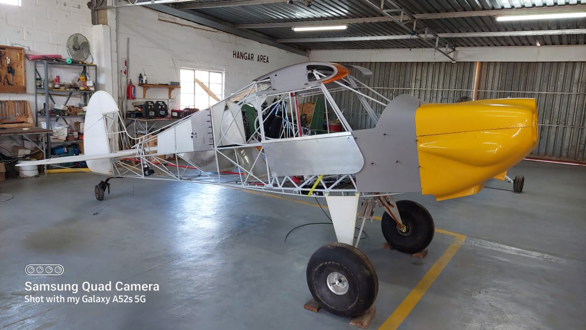

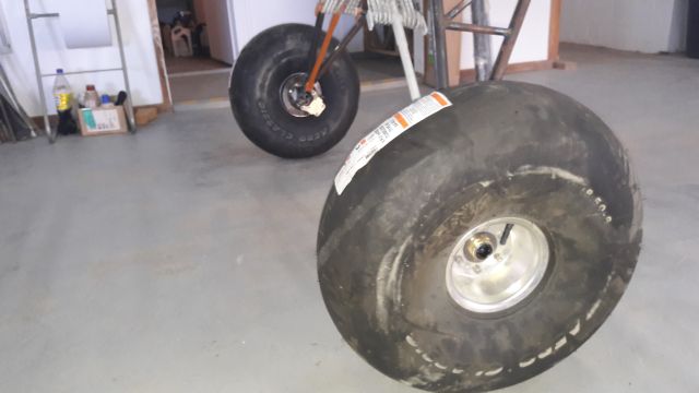

Postby Jean Crous » Fri Jul 09, 2021 4:59 pm

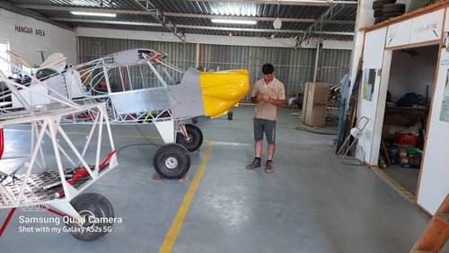

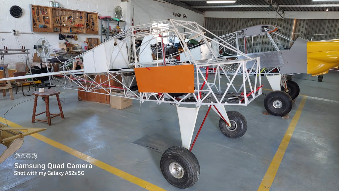

As promised a few photos of the progress on the Cubby Renegade.
Jean.

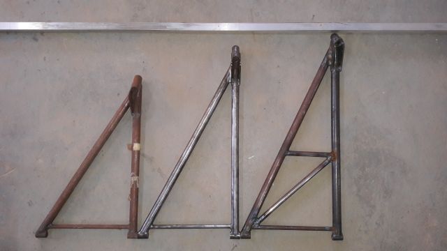

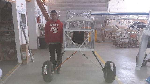

The shoert leg is the original Cubby MK1 the middle is the Cubby MK2(now called Maverick), and the long one is the Renegade leg.

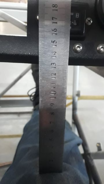

The Cubby Renegade will have a tall stance, my nephew is 6ft1inch.

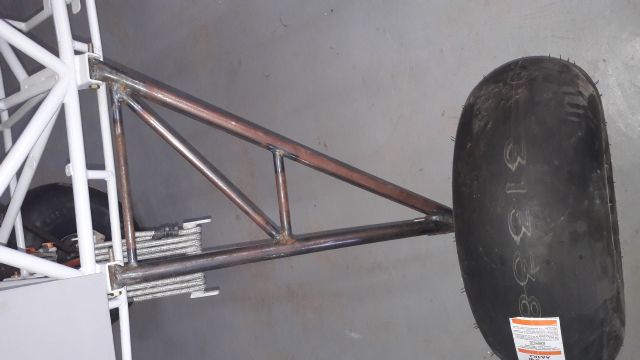

22inch tundra tyres
Main gear legs have been beefed up to take the big tyres.

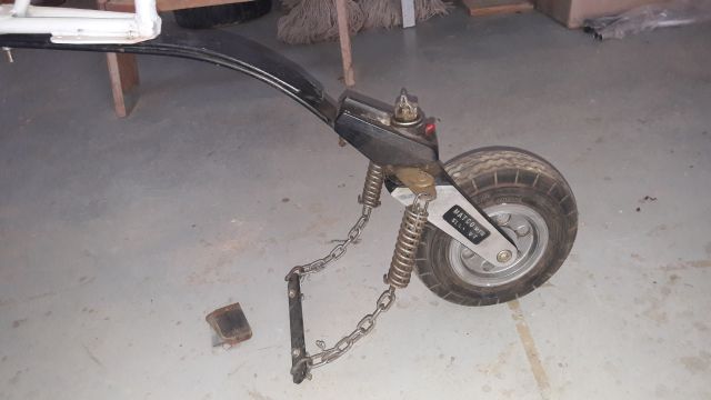

8 inch pneumatic Matco tailwheel goes well with the big maingear.
