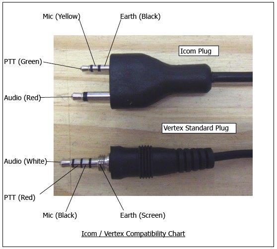

Anybody got an idée where I can get this Coms connector plug (bottom on photo)
(Without thread - Earth Just push in on radio)
That plugs into Icom IC – A5 radio.
My plan is to cut plug on Buzzcom system (top on photo) and connect Icom plug for radio.
Any info or advice would be appreciated.

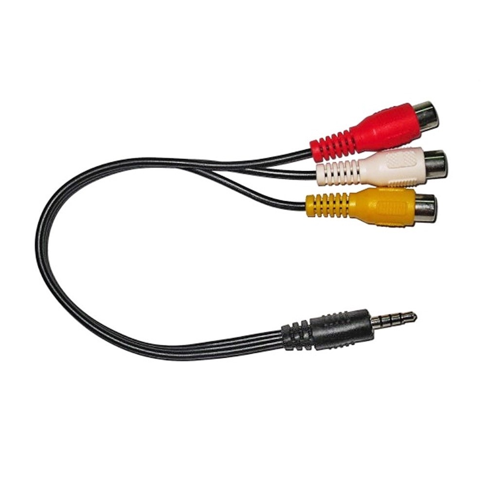

Try places that sell cables for video cameras - Cash Converters, Dions, Hi Fi Corp etc
They have the 4 pole connectors without the thread

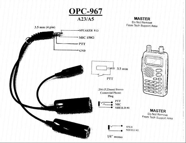

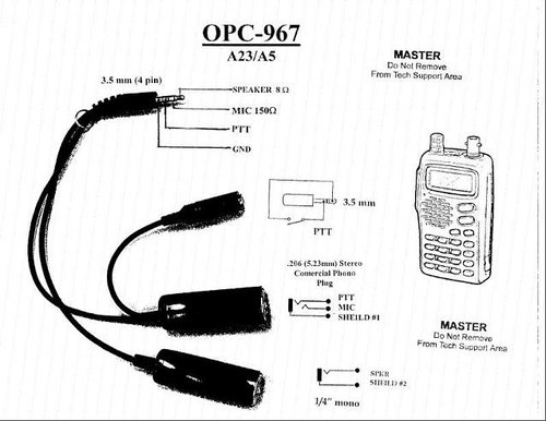

The picture you posted is for the Yaesu/Vertex radios and the wiring for the IC-A5 is a bit different different
This shows the IC-A5 wiring
TV AV cable with 4 pole connector
