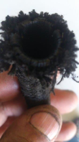

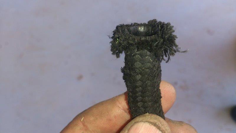

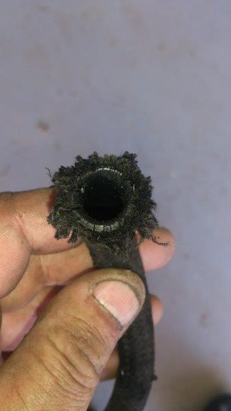

Any body that can tell me where I can buy "clear blue urethane" fuel line in Cape Town area.
During pre-fight discovered fuel and oil pipes cracking on the ends.
Decided to replace all my rubber pipes, oil and fuel with this type (clear blue urethane) that I saw on couple of trikes .

Hi I got mine from USA and it doesnt last. Suddenly starts to change color to blueish white and just disintigrated without warning. Will never use this again.
Fitted the correct fuel grade black hose made by goodyear and no more issues.
That hose in your photo isnt proper fuel grade hosing hence its cracking up now.
